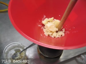

Batch #9 (0.0055 scale). OrgSyn cautions that there must be sufficient freeboard in the pot due to foaming. Therefore the batch size from above was cut in half. The quantities used were: castor oil, 65.1g; NaOH, 16g; water 32 ml. The components were mixed to saponify the oil prior to transfer to the pot. I recommend that the transfer be made before the oil turns into the hard curd shown below.
saponified castor oil curd.jpg - 71kB
The same distillate water recycle system was used as in batch #8, as shown in the pictures below.

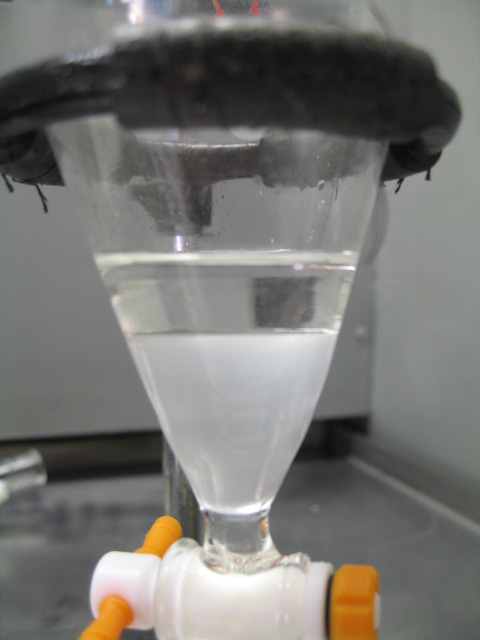

Once 10 ml of water had accumulated in the separatory funnel it was drawn off and transferred to the P-E funnel. From there it was reintroduced to the pot drop-by-drop. There was no foaming problem. The electric mantle heat was set at 65% with the pot and Claisen insulated with fiberglass blankets. Stirring was done using a magnetic stirrer. The putative 2-octanol (oil) and water co-distilled, separating in the condenser. After setting overnight in the separatory funnel the oil and water layers separated nicely as shown in the picture below.
distillate receiver for 2-octanol.jpg - 61kB
distillate receiver
The yield was ~ 9 ml of crude oil, which is about a 26% yield.

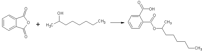

2-octylhydrogenphthalate
2-octylhydrogenphthalate was made using phthalic anhydride (PAN) and some of the 2-octanol synthesized above.
2-octylhydrogenphthalate.gif - 3kB
Reaction of 2-octanol with phthalic anhydride
I found 2 procedures for this synthesis, ie, that in Vogel, and that in OrgSyn (ref 1). I chose the OrgSyn procedure as it had the easiest workup. The only potential downside to the OrgSyn procedure is the required reaction time of 12-15hrs. However, by using a PID controller to keep an oil bath at a constant 110°C this required no attention.
I had several failures before discovering that my PAN was bad. Most likely it was instead phthalic acid (PA). So I painstakingly made 6g of PAN wool by gathering it as it sublimed from PA heated to 185°C. I have posted a warning concerning this in Prepublication following my procedure for converting PA to PAN. PA can be easily distinguished from PAN using chloroform (see Brewster, p. 119, forum library).

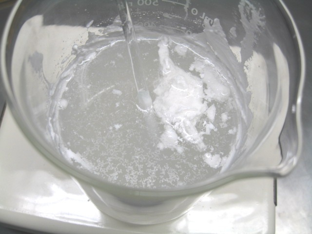

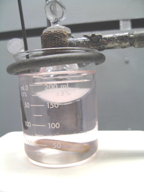

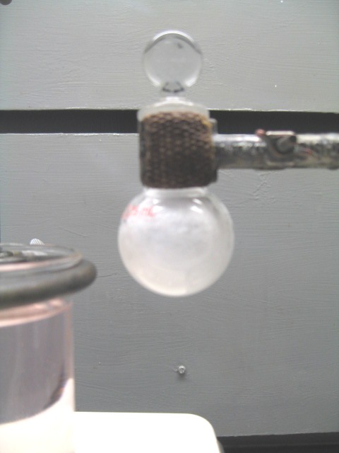

Procedure
5.3g (0.0405 mole) of 2-octanol was placed in a 25ml RBF. To this was added 6.0g of PAN wool (0.0405 mole). PAN wool is voluminous and had to be stuffed into the flask as shown in the picture below:
25 ml RBF with 2-octanol and phthalic anhydride.jpg - 51kB
25ml RBF with 2-octanol and phthalic anhydride
The RBF was closed with a glass stopper and placed in the silicone oil bath on a magnetic stirrer-hotplate. The oil was stirred magnetically; the oil temperature was maintained at 110°C using the PID controller and a TC.
After about 3 hours most of the PAN had dissolved/reacted as shown in the picture below:
phthalic anhydride remaining at 3hrs.jpg - 57kB
phthalic anhydride remaining after 3hrs

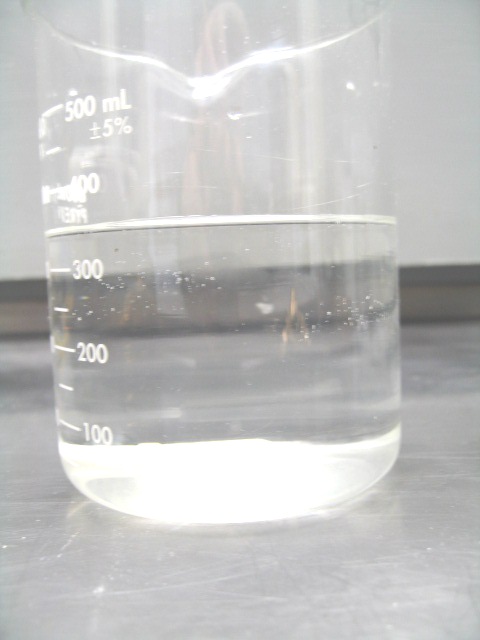

After 15hrs the product was poured into 342ml of water containing 6.1g of anhydrous Na2CO3. This formed the sodium salt. OrgSyn stated that if the salt solution is hazy it is because of 2-octanone contamination. As you can see it is perfectly clear:
Na 2-octyl phthalate.jpg - 49kB
Na 2-octylphthalate solution
About 20ml of 6M HCl was then added to make the solution distinctly acid (est. pH 3-4). This formed the 2-octylhydrogenphthalate. At first a fair amount of oil formed, floating on the surface. I left the lab to research what I might do to crystallize the oil. I could find no help. However, by the time I got back to the lab about 1/2hr later the oil had disappeared turning into floating white solids, as shown below:
2-octylhydrogenphthalate.jpg - 67kB
The solids were caught on a 7cm Buchner funnel, ground in a mortar with water, sucked dry, washed with water, sucked dry again, then placed in a desiccator to dry.
The yield of crude product was near quantitative. Its melting point was found to be 46-47°C, even after washes with 95% ethanol and ether (OrgSyn value: 55°C). I chose not to recrystalize it from glacial acetic acid or petroleum ether. OrgSyn recommended this if highly pure material is required.
