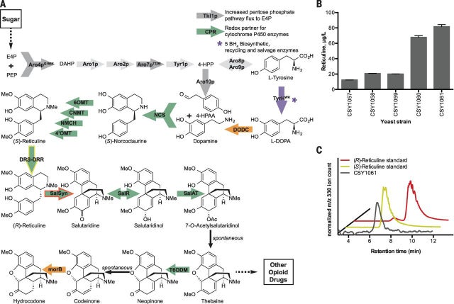

https://www.reddit.com/r/DrugNerds/comments/my6q19/complete_...
Without genetic engineering, Biosynthesis only tends to be helpful if you can take advantage of the activity of an enzyme that is already present. Take for example the activity of producing l-PAC from benzaldehyde in yeast. Some others hypothesize that safrole can be produced from Vanillin if fed to some certian species of soil bacteria.
You would need equipment to make a stable cell line expressing the necessary genes and subsequent culture of the yeast. Then you'd need equipment for the scale-up from initial cell line creation to a volume big enough to produce an appreciable amount (so a large bioreactor, or lots of incubators with space for flasks). Then you would need a purification process to extract the morphine from the yeast media and remove everything else. I'm not going to cover that here but it's a whole separate endeavor from MAKING the morphine.
To get past even the first step, you would need:
Space to culture the yeast. An incubator, specifically a 37 DegC one that keeps a certain % of CO2 in the incubator air.Here's an article on how to DIY one for $350. Here's a manufactured one for $1500 on ebay.
A hood to perform sterile work in, so your yeast culture does not become contaminated. Here's one for $1500 on ebay and here's a new HEPA filter for it. You'd need some bleach to decontaminate it when you started, and ethanol to clean it before every use.
General lab equipment (pipettes, centrifuge...) Here's some pipettes. This centrifuge might work. You'd also need some consumables.
Big one: Cell culture media. The yeast needs to grow in a specific solution. You dissolve this stuff in water but then need to sterilize it... which leads to next item.
Autoclave. You need to be able sterilize the flasks you culture with, as well as anything that will directly touch the yeast culture (glass pipettes when replacing culture media, among other things.)Here's a cheap one.
So to total up this shitty list... 1500 + 1500 + 900 + 500 + 160 + 100 = about $5000. Then add in all the money you'd spend on tubes, media, and culture flasks and all the other things I didn't mention.
_oEeMaETXqX-t_WwLQK-mQonu9oQpQK3mM3xscoENiE.jpg - 51kB
