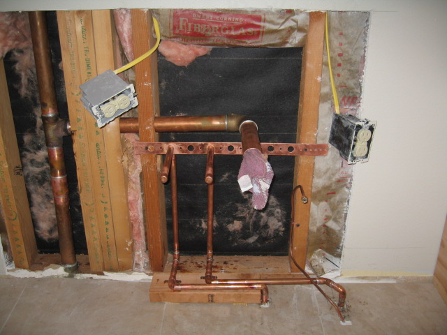

[*] posted on 19-6-2013 at 07:17
The regulator and torch are heavy! They are massive brass and together they are at least as heavy as a full cylinder of propylene. The torch is useful for me as well. It produces a very nice hot flame, ideal for glass blowing, e.g. making ampoules.
I saw this same torch/regulator in use yesterday! I am having my kitchen rebuilt and a plumber was using just such a torch on MAP/Pro gas. The swiveling and fine pressure regulation were impressive. This is what it looked like although I neglected to look at it closely to get brand/model:
http://www.grainger.com/Grainger/LENOX-Swivel-Torch-4NE79?Pi...
The plumber was very skilled. Here's a picture of his work:
plumbing revision.JPG - 110kB
[Edited on 19-6-2013 by Magpie]
