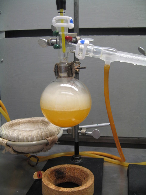

The below picture shows an abandoned distillation to recover the chlorobenzene. You can see the P2O5 smoke in the pot as the hot P reacts with the
oxygen in the air.

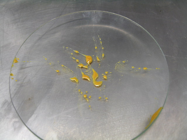

The composition of the yellow colored residue is still unknown. It is not soluble in the chlorobenzene and settles out as a gummy yellow residue. At
first I though it was P4S10, but where would the sulfur come from (thiophene?). I carefully cleaned and redistilled the chlorobenzene before use.
Also, I have never smelled a sulfur smell. When I heated some strongly with a match it did not catch fire but melted slightly and turned partially
black. It is soluble in water and turns the water pH acid.

I gave some thought to continuing the chlorination but decided to just cut my losses. There are reactions taking place that I don't understand.
Also, I'm getting tired of running the hood fan, cleaning glassware, and generating used nitrile gloves. Working with dissolved phosphorus and a
halogenated solvent requires extra caution and maintenance of good hygiene.
The product continues to form the yellow residue. Today I filtered most of it out then set up for distillation to recover the chlorobenzene and try
to burn off the P to P2O5 using a controlled burn, ie, get it hot and expose it to the air. This did occur during the distillation. As the P vapor
came in contact with air at the entrance to the condenser it would form smoke. This in turn would cause a partial vacuum and suck in more air,
repeating on and on. I would have taken a picture but my camera quit as the battery needs recharging.
The distillation is done. The distillate is tainted a fluorescein yellow and there is an orange deposit in the pot.

@Magpie,
Based on the "tiny amount" of reactants, your Hemple column with glass beads must hold quite some PCl3 (by capilarity you may have several grams in
there)...this may account for the apparent low yield.
PH Z (PHILOU Zrealone)
I didn't use glass beads but ss scrub pad. But, yes, there was some of the yellow residue on the pad coils.
The 1M CuSO4 reacts fast with the small particles of waste, turning them black immediately. I will let it set a few days then treat this with 5%
NaOCl to destroy the phosphides.
The only waste left will then be ~ 150ml of chlorobenzene*. I see my choices here as 1) incineration, 2) evaporation, or 3) absorb in kitty litter.
I have tried some incineration on a small scale: very nasty with sooty smoke likely containing nasties like HCl and dioxin. I think this choice is
out.
*It is interesting to note that there was a fair amount of solid waste (orange gunk) in the chlorobenzene distillate. The chlorobenzene is therefore
also getting treated with 1M CuSO4.
