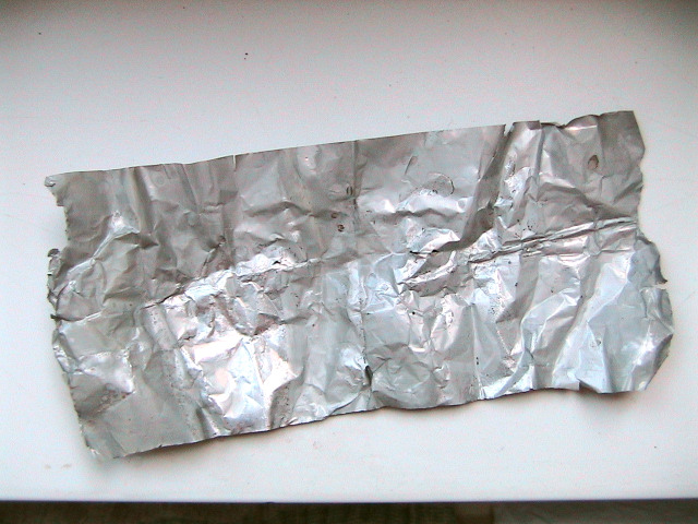

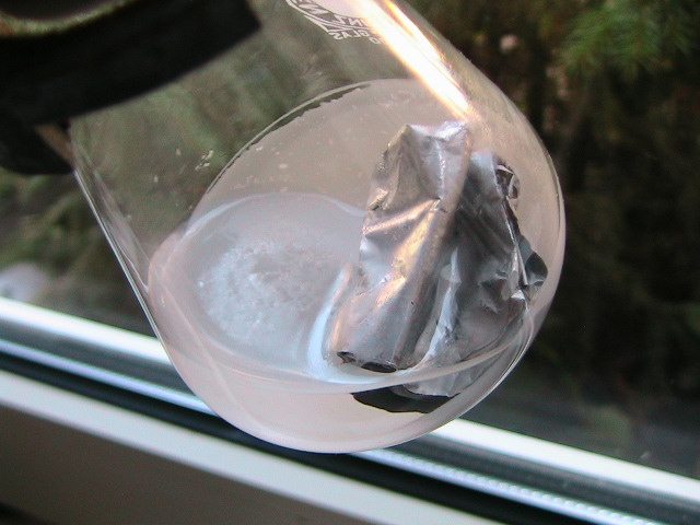

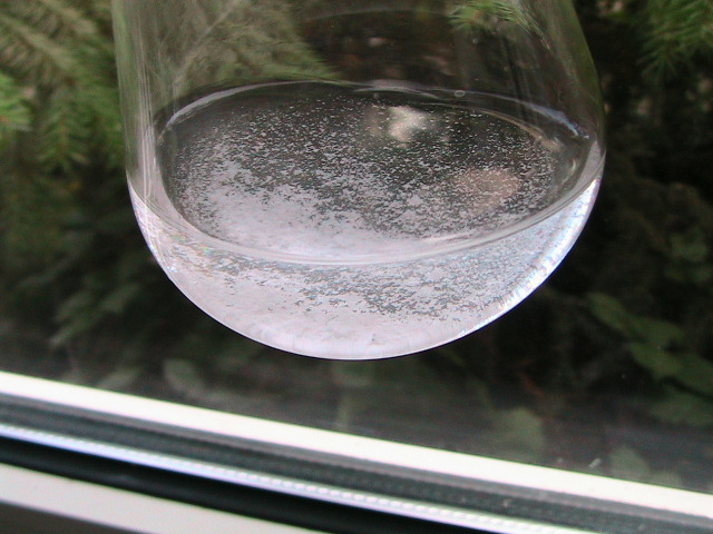

8 days ago, I put some strong ammonia (18/20° Baume) in an erlenmeyer flask and put a piece of aluminium foil in it. Teeny tiny amounts of gas
evolved, the bubbles being on the verge of visibility for the human eye. This was left to react for 8 days, at a temperature of around 20°C.
Today, I took out what has remained of the foil, and poured off the solution. On the flask, a white substance had formed. It did not dissolve in 10%
acetic acid, and neither in 5% hydrochloric acid, not even when heated to boiling.
Below are some pictures of the results. The substance formed was pure white, but in the pictures it is a bit coloured due to the lighting conditions.
![IMG_6768_adj-20+20_small.JPG - 129kB](http://www.sciencemadness.org/talk/files.php?pid=220365&aid=15769)
Try dissolving it in stronger acid and stronger alkali (NaOH or KOH). If it dissolves in the latter you can be fairly sure it's (hydrated) alumina.
If it really is hydrated alumina, what this would clearly suggest is that there's enough OH- (but not much: even at that strength an ammonia solution
is a weak base) to attack Al and produce hydrated alumina but not enough to create aluminate
(Al(OH)<sub>4</sub><sup>-</sup> because:
NH3(aq) + H2O(l) < === > NH4+(aq) + OH-(aq)
... leans strongly to the right.
[Edited on 28-8-2011 by blogfast25]

shouldn't aluminum hydroxide dissolve readily in dilute HCl?
Depends a bit on strength and age of the oxide, really... Of course the precipitate could have been something in the ammonia but I can't think what it
could be.

To the left, that is... And indeed, no aluminate is formed.
Since not all of the foil dissolved, the white material is not the oxide skin of the foil.
IIRC, aluminium hydroxide is a voluminous, jelly substance, so I'm inclined to say the white substance be the oxide. In addition, the hydroxide would
have easily dissolved in 5% HCl.
I discarded the reaction products, so I can't do any furhter testing. I'm amazed though, that with a weak base like ammonia, the foil has reacted at
all.

In the first pictures it looks like there is more white material, a slime or gel?
Is it possible that some of the material was lost when you poured of the original liquid or during subsequent filtration/decantations?
I agree, the amount of material is to great. Ammonia is used in a number of anodizing mixtures for Al, is it possible it catylised the crystallization
of the aluminum hydroxide?
The oxide layer on the foil may have been thick enough to provide seed crystals.
