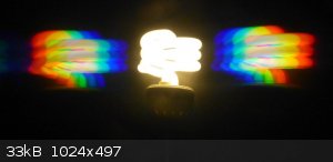

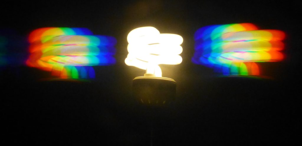

Not if you just measure the yellow object. Just like if you want to measure a book you don't measure the entire bookshelf.
Optically this would involve imaging lenses, or a mask, so you are only looking at the object of interest, rather than the average of an entire room.
The attached image is of a fluorescent bulb as seen through a diffraction grating. You will notice there are 5 distinct images, as the bulb emits light on 5 distinct wavelengths, and the grating separates them out.
Applying this to your yellow object: if it were only reflecting yellow you would see one yellow image; if it were only reflecting red and green you would see two images , one red and one green. Does that make sense to you?
Most everyday objects reflect a broad band of wavelengths, and so would appear as a rainbow colored smear when viewed through a diffraction grating.
30_fluorescent-lights_diffraction-grating-1024x497.jpg - 33kB
