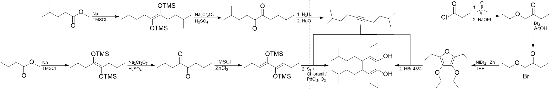

Here would be a complete scheme of things (left in both potential diene paths), instead of the McMurry addition-elimination sequence for the dienophile I came up with an alternative approach going via the hydrazone of the corresponding diketone and eliminating with HgO.
For the 1-ethoxybutanone precursor I thought of an approach resembling the Nugent-homologisation using ethoxide as a nucleophile rather than the classic chloride (the sulfur species should be available from methyl iodide and DMSO followed by treatment with base).

[*] posted on 1-2-2025 at 04:25
Thanks Niklas - that's a really big help!
For the 1-ethoxy-2-butanone, I really do not want to work with methyl iodide, do you think there could be another way to make it - that also uses accesable starting materials? I have played around in ChemDraw for a while now, but somehow can't find a way :/. Maybe something starting from glycolic acid, acetic acid or chloroacetic acid? I have *too much* ethyl bromide on hand, so I would love to use that, if possible :P
Secondly, for the hydrazine part, could I use an alternative to HgO? I really do not want to work with mercury compounds either.
Oh, also, how would you make the isohexanoic acid? It's quite hard to find where I have looked, or very expensive - like 25 mL = 80 €.

[*] posted on 1-2-2025 at 13:57
One alternative tho longer approach I would have in mind for the 1-ethoxyburanone would be to start from acetonitrile, monobrominate in GAA, make the ethyl ether by reaction with sodium ethoxide (would likely have to use two equivalents as the product would quickly get deprotonated), and then react with the Grignard reagent of ethyl bromide, what should selectively result in the ketone as nitriles have no way of reacting twice.
For the isohexanoic acid a classic Grignard approach using CO2 is probably best, this would take you back to isopentyl bromide which itself is available from the cheap alcohol by reaction with HBr.
Regarding alternatives for the alkyne synthesis I‘ll have to look through some literature, it is worth noting out tho that the HgO in the proposed path is only catalytic (the diphenylacetylene synthesis on Orgsyn uses 2-4 g for 0,5 mol), so it’s not like you would have to handle equimolar quantities of mercury salts, but yeah getting around its use is definitely still preferable even if one has the capabilities to handle and dispose of it.

[*] posted on 2-2-2025 at 02:04
Thank you Niklas!
So would our approach be something like this?
It's quite a few steps longer, but do you think still it's plausible?
