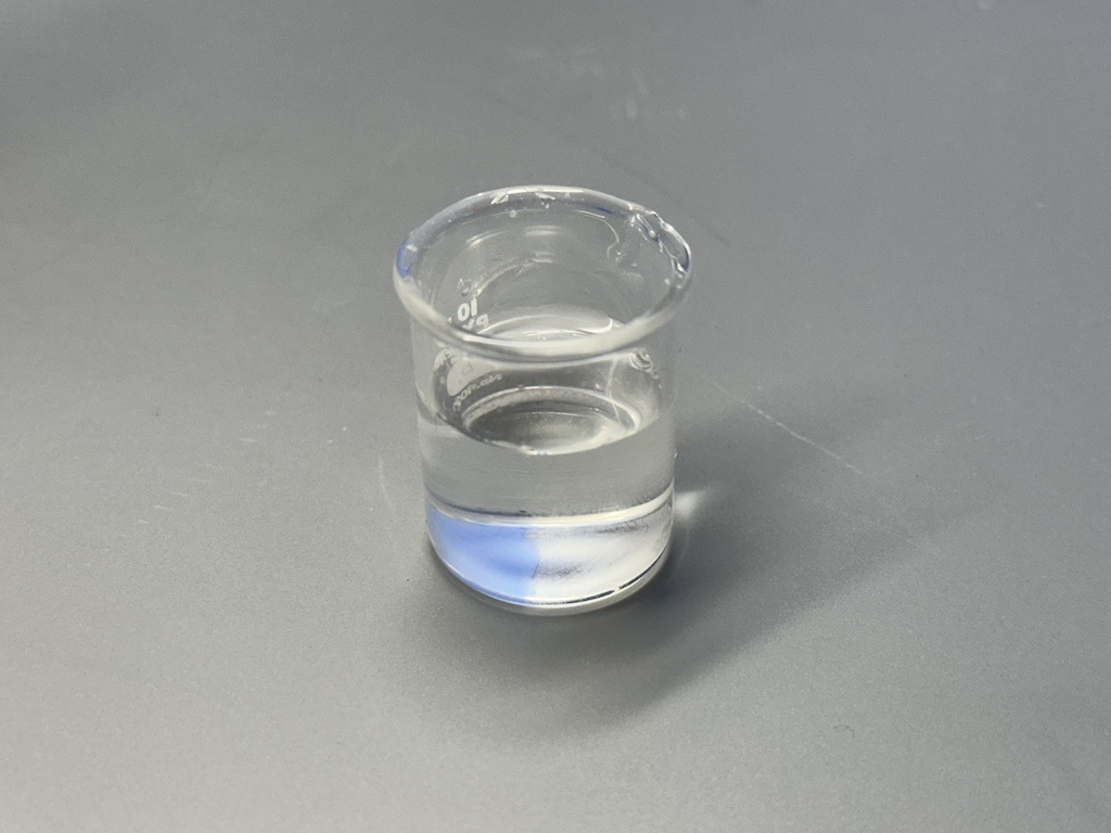

Glycine and Urea were placed in a 10 mL beaker.
Approximately 6 mL water added and stirred until everything dissolved.
Heated in microwave (on low) for 1 minute, then stir.
Heating/stirring repeated for 10 minutes, never allowing the beaker to boil.
Beaker left overnight to cool and complete reaction.

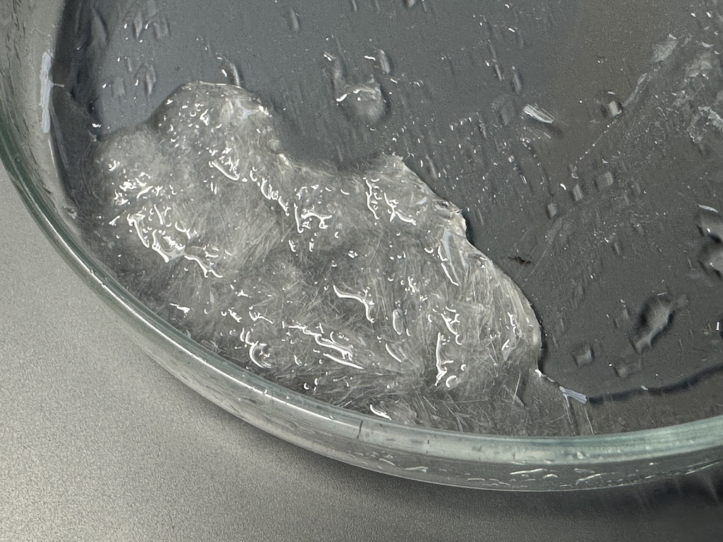

After crystals formed spontaneously the dish was left to evaporate at room temperature for 24 hours.
Crystals (still wet) were scraped together and 2 mL fresh water added to the dish, stirring the wet crystals into the fresh water to wash them.
Crystals were scraped to one side of the dish and the liquid left to evaporate again.
hydantoin_crystals.jpg - 350kB
Still waiting for the crystals to dry so I can weigh them.

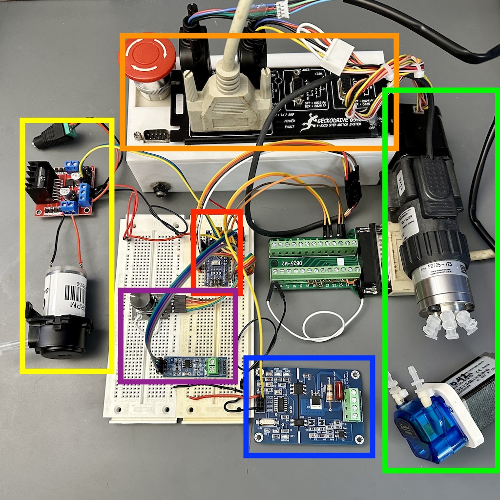

Permanent home - https://github.com/Adivinedude/PCM_Modbus

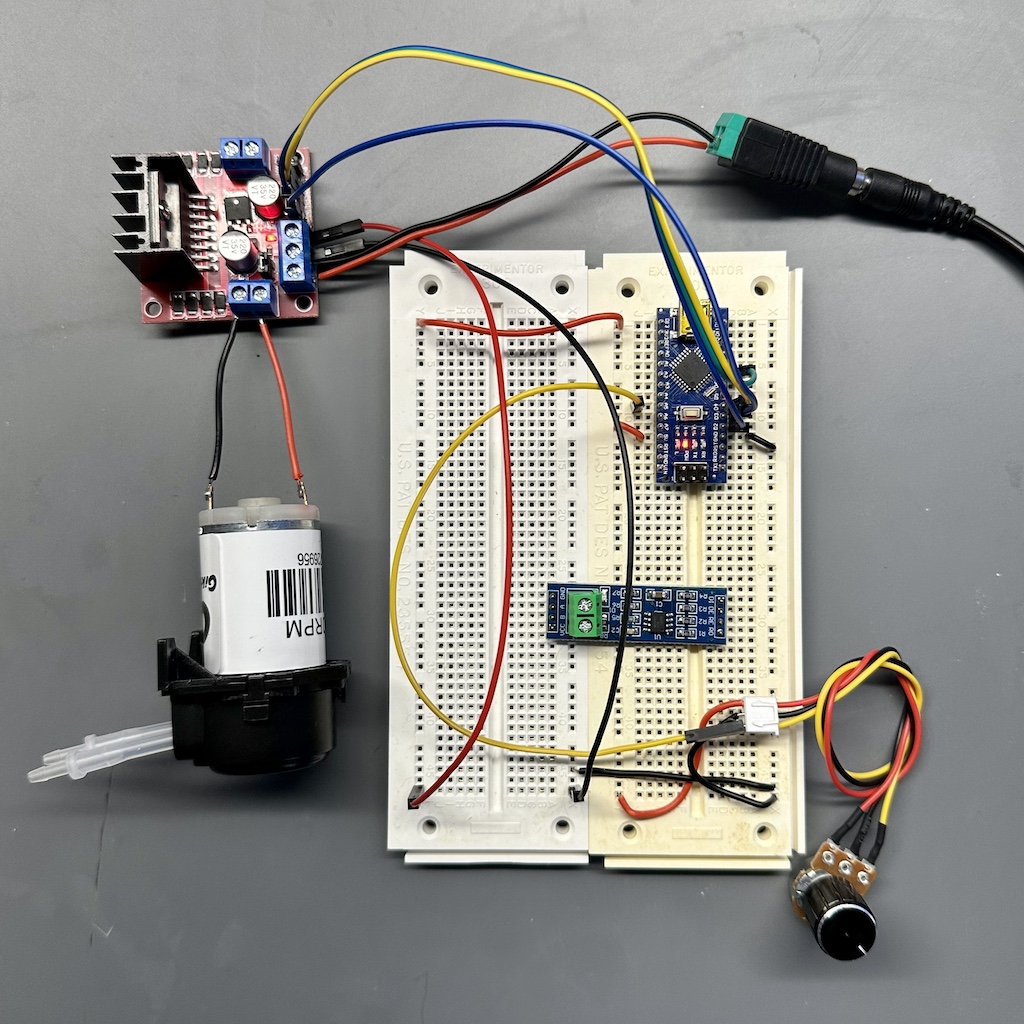

1 uno with the hardware I linked can run
4 dc motors (2amp 7-32v)
4 5v logic servos
2 stepper motors, in full steps, 2 amps, 7-32 volt, at 1.5k steps per second
4 pulse step drivers.
not all at once, but many workable combinations.
this is just version 0.1 there is a lot of room to grow.

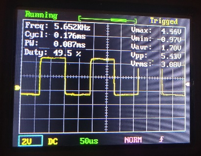

added a pulse step mode for your G540 per their datasheet
clocked her at 5.6k steps per second.
20231121_194528.jpg - 66kB
That is a really nice driver by the way. out of my price range.
That will most likely rip the gears our of your pump if you drive it that fast.
I will add a some bits to control acceleration but will be after the holidays.
as for your overheating issue.
be sure to use the proper current setting resistor. that driver works like a current
source, at slow speeds it uses less voltage, but as speeds increases, the
impedance of the motor coils goes up, requiring more voltage to drive the load at
full current/power.
Without the proper resistor, it will overvolte the motor at lower rpm and holding states
Using my little setup, torque will be lower at high speed because an h-bridge is not
a good way to drive a stepper. it works but there are better options.
None which can operate this wide variety of motors for this price point.

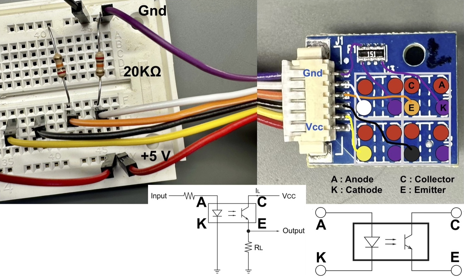

Totally pulling my hair out on these photo-interrupters. Does anyone see where I may have gone wrong?
I've attached a reverse-engineered wiring for the sensor board, a breadboard test circuit, and the wiring diagrams from the documentation of the photo-interrupters.
If I understand the circuit correctly, it should work like this:
- When powered with 5V, the photo-interrupter's LED (labeled A,K) will illuminate continuously.
- This will allow current to flow across the photo-interrupter's detector (labeled C,E).
- Since the collector is tied to 5V, the emitter will pass 5V until the LED is blocked.
- The output pin will read HIGH.
- Once the LED is blocked, the collector stops passing current, leaving the emitter to float.
- The floating emitter is tied to ground by a high-resistance path.
- Thus the output will read LOW.
I've tested various pull-down resistors, specifically 1K, 20K, and 1M, which I've seen mentioned in some hardware threads for similar circuits.
sensor_wiring_check.jpg - 418kB

On your drawing you have
"Input" > resistor > 'A'. Assuming "input" is Vcc to power the led, then your wiring is backwards
You have "purple wire" Gnd > resistor >anode
It doesn't matters but is convention to place resistors before the anode on leds.
Got a good meter?
1. Ohm out each channel of the resistor array. (black chip labled 151) make sure they are all equal +/- 10%
2. Switch to diode test and ring out the leds, verify orientation (cathode and anode), and record the voltage drop.
These 2 test and measurements will tell you everything you need to know to about
this circuit
For example, if the K/A voltage drop is ~2.0V and the resistor is 150ohms,
assuming a current of 10-20ma(standard current for this type of device) we can say
Vcc = resistance * current + diode voltage drop
Vcc = 150ohms * 20×10^-3 + 2v = 5v
Or 150ohms * 10ma + 2v = 3.5V.

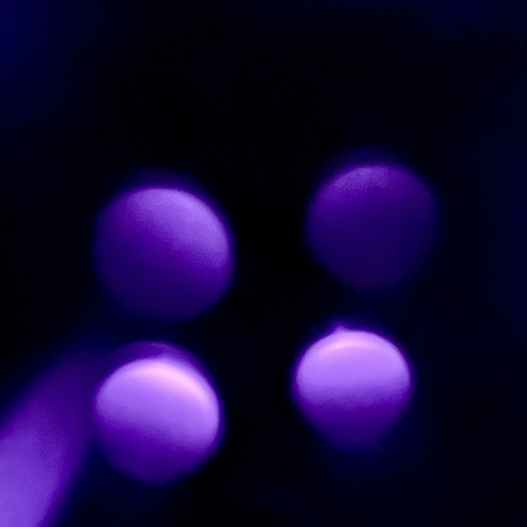

A cool way to test an IR led is to power it, turn off all lights, and view it through a cell
phone camera. It will show up as a redish purple. Great for tv remotes.
Edit: 20k pull down resisters are kinda big and will limit the output reaction speed.
The emmitor collector capacitance will form large RC time constance.
Also, shield the device from all light sources when testing. Just in case ambient
light is an issue
[Edited on 23-11-2023 by Rainwater]

Ok.. you shamed me into getting a real ohmmeter. Had an old one that died awhile back and I've been limping along with a household voltmeter since.
Checked the resistor: 149, 149, 150, 148
Checked the diodes: You're correct they are reversed - the data sheets I found are not compatible with the parts on the board.
Verified this using my cellphone camera by powering the circuit and reversing the connections (purple = +5v, red = Gnd).
Finally wired it all back up with the Arduino and tested the inputs with a 10K resistor.
It works!
ir_success.jpg - 190kB

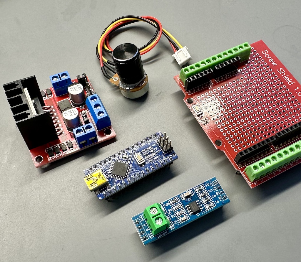

Stuff arrived! I'll get on the breadboard construction and test out the new code.
Rather than one controller controlling 4 pumps of various types, I'm thinking of packaging each Arduino with parts such that it can control:
- Valve (stepper + inputs)
- Stirring (DC motor)
- Hotplate (PWM)
- Thermometer
- Pump (stepper)
This would simplify my setup because I can design one box containing all the components needed (resistors, knobs, plugs) to run any piece of equipment. Then deploying new equipment (valve, hotplate, etc) is just plugging it in to the appropriate free port on one of the control boxes and adjusting the config files to describe what equipment is connected.
some_hardware.jpg - 411kB

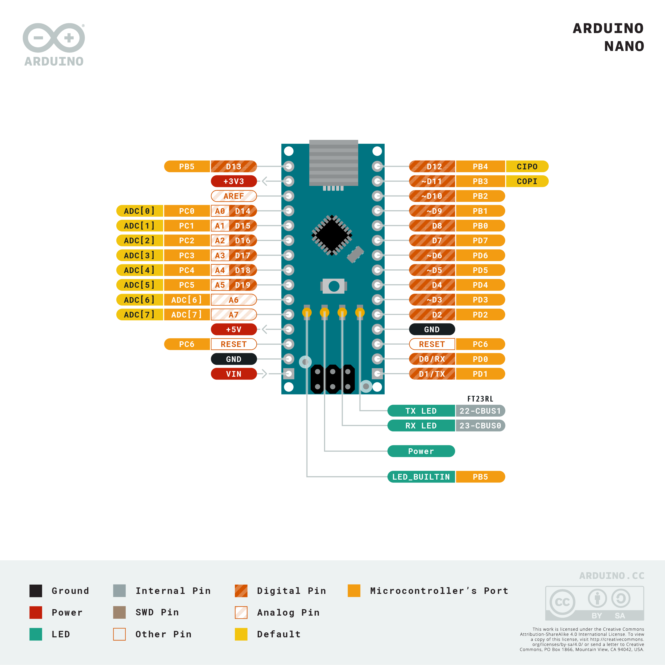

It lives!
Excellent work Rainwater, the latest code ran right out of the box. Had a bad motor driver (L298), did a bit of code debugging only to discover it's a bad board, ugh!
Haven't attached the ModBus board yet, the pins are labeled differently from your schematic.
Pins on board: DI, DE, RE, RO
I'm assuming the pins are RO->RX, DI->TX, and DE/RE tied together, but to which pin? Still using MOSI?
Also, do all ModBus devices tie their pin 'A's together and all the pin 'B's tied together (like a bus), or are they plugged in serially (like pin A of device1 goes to pin B of device2, etc)?
Thanks, this will accelerate the project nicely!
breadboard.jpg - 386kB
move.w %0x2700,sr
movem.l d0-d7/a0-a6,-(a7)
lea science,a0
jsr madness
Rainwater
Posts: 961
Registered: 22-12-2021
[*] posted on 1-12-2023 at 02:36
Quote: Originally posted by mc68k
It lives!I'm assuming the pins are
https://github.com/Adivinedude/PCM_Modbus/blob/main/sketch_P...
Code:
for the ATmega328p RS485_TX 1 // PD1 RS485_RX 0 // PD0 RS485_DERE 18 // A4 PC4
Pinout-NANO_latest.png - 271kB
together
yes
Be sure to use a common ground between your controller and devices. Earth ground
should work. Ensure ground resistance between all devices is less than 100 ohms.
This will prevent common mode offsets that will damage the MAX485 above
15v/-15v and eliminates a lot of transmission noise.
If earth ground is unacceptable, using a 3 wire communication cable to carry the
ground will fix this.
[Edited on 1-12-2023 by Rainwater]

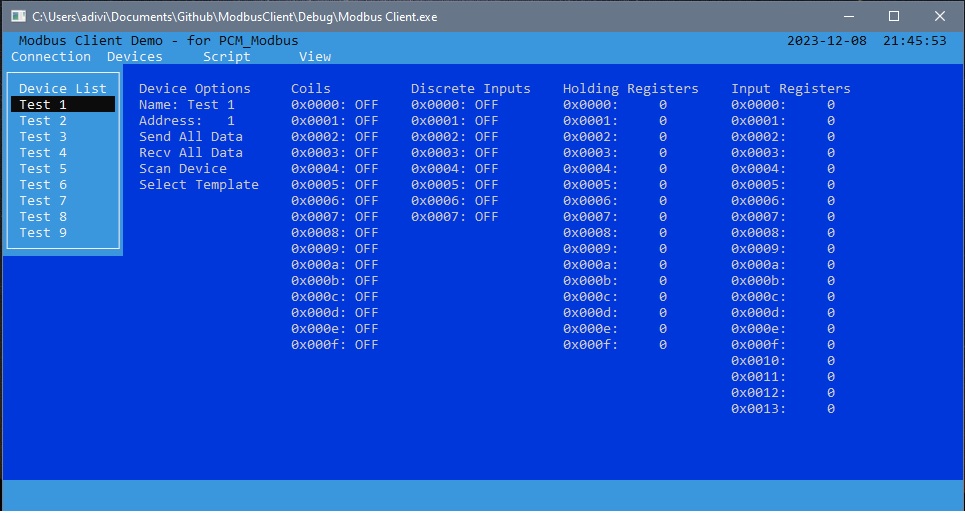

Its just a shell right now, gonna start adding communication functionality here soon.
I been working on the PCM_Modbus code by hand writing request, not fun.
I slapped this together while I recovered from the flu. should be working soon.
Currently taking request for features
    ToDo List:
  1. Translate modbus addresses into readable names
  2. Spotlight Changed Values
  3. Implement Command Passthrough
  4. Pick better colors
PCM_Modbus Demo app.jpg - 136kB

Chemputer Hardware:
chemputer_9_dec_23_marked.jpg - 467kB
Code:
Red (center) : Arduino Nano microcontroller Orange (top) : G540 stepper driver Yellow (left): L298 DC motor driver board (top) + peristaltic pump (bottom) Green (right): Liquid port selector valve (top) + peristaltic pump (bottom) Blue (bottom): PWM to A/C dimmer board to control a hotplate Purple (ctr) : MAC485 ModBus port for communication and rotary knob for address selection
Chemputer Progress:
- Rainwater's code controls all the pumps and ModBus communications.
- My valve control code is separate, not yet integrated with Rainwater's state machine.
- I added a simple serial command parser to turn on/off the various components.
- I replaced the POT with a rotary knob, which is more precise, and has a button for selection.
- The board on the bottom (blue) is new and hasn't been tested yet. It should allow the Arduino to control a hotplate using a single PWM pin! (https://www.amazon.com/dp/B06Y1DT1WP)
- I reserved the I2C pins for a few peripheral boards that should round out the package: LCD display, data logger, and balanced PT100 temperature sensor board.
So this tangle of wires represents an almost-complete controller module! It's only missing the temperature sensor.
The expectation is that a chemputer would consist of several of these controllers, each controlling a reaction vessel (with hotplate, stirring, temperature sensor) and add additional capacity to the liquid handling backbone (6 ports and a pump).
My target is 3 of these modules - that will enable control of the main reactor, filter module, and liquid/liquid separator. It also allows selection among (6*3=18) ports. Although some ports are reserved, and some ports are used to connect the valves to each other.
The main valve has water, gas, vacuum, and waste connected to four of its ports. The last two ports connect to the other two valves. This means there's really only 12 ports available.
Destination modules:
- Reactor
- Filter
- Separator
The remaining 9 ports are available for reagents.
Rainwater,
I like the colors! Very cool and soothing.
The console app looks great, that will be very useful for testing and debugging. The changed-value highlighting would be especially amazing.
I agree that sending ModBus commands "by hand" is aggravating. I resorted to writing individual test functions and invoking them through the Arduino serial port. For example, typing "+0" turns on pump 0, while "-0" turns it off, and "S0100" where 'S' means 'set speed', the first 0 is the pump number, and the last 3 digits is the desired speed.
