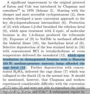

Oh that's because..... um...... hm I have no idea. Why did they use a medium pressure lamp? There's a small peak in the 300-350 range but its
<1/10th the size of the main peak at 250nm.
Maybe you have to always target the first transition in a photochemical reaction? Ground/S0 -> S1 transition, not the S0 -> S2 or whatever? They
must have used a medium pressure lamp for a reason, but I fail to see how the Supp Info figure shows that "300-350nm is a critical region"

I also fail to see why one peak should be favored and would love an explanation.
Posts: 3026
In the article they state their lamp is inefficient for this process, and 300-350nm is the optimum... So I'm leaning towards the 310nm lamp...
Edit: screw it, I just bought the 310nm lamp. If it doesn't work I can always buy the 254nm one, those are only 10 euro and fit in the same socket.

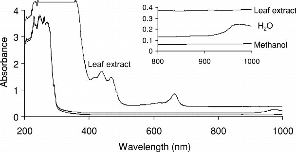

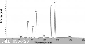

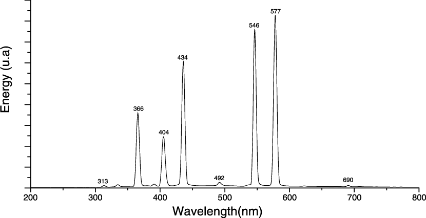

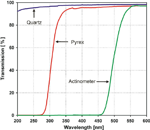

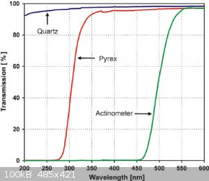

Posts: 3026
I just realized they use a pyrex reaction for the photocyclization, which absorps anything below 275 and most below 300nm anyway... not sure what to
make of that. Would that mean lower wavelengths do work but are not considered as they are not transmitted by the pyrex anyway, coming to the
conclusion 300-350nm is the optimum because that is the lowest that can pass. Or did they use the pyrex reactor because 300-350nm is the optimum
anyway?
![pyrex_quartz_transmission.png - 100kB](http://www.sciencemadness.org/talk/files.php?pid=639589&aid=81908)
Edit: this is the spectrum of a medium pressure Hg lamp after pyrex filtering the light.
![emission_Hg_medium_pressure_pyrex_filtered.png - 14kB](http://www.sciencemadness.org/talk/files.php?pid=639589&aid=81910)
[Edited on 1-7-2020 by Tsjerk]

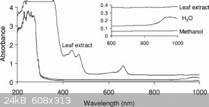

Posts: 3026
Well, the 85:5 methanol/water solvent system used by Falkiner et al. also absorbs significant amounts of everything <300nm, just as the benzene
does. So I don't think conspiracies theories are needed here as an explanation (bummer), and pyrex is just cheaper than quartz.
![methanol_water_UV-VIS.png - 24kB](http://www.sciencemadness.org/talk/files.php?pid=639599&aid=81914)
Tdep
Posts: 516
Registered: 31-1-2013
That's a weird diagram, because I know methanol is transparent to UV down to about 215nm, I've used it as a solvent for UV-Vis. Methanol/water mix
won't absorb the 250nm low pressure mercury emission peak at all. But yes, maybe the critical region really is just where the substance absorbs but
normal glass transmits fine
Posts: 3026
The scale on that last graph is logarithmic, so absorption would be around 10% max indeed.

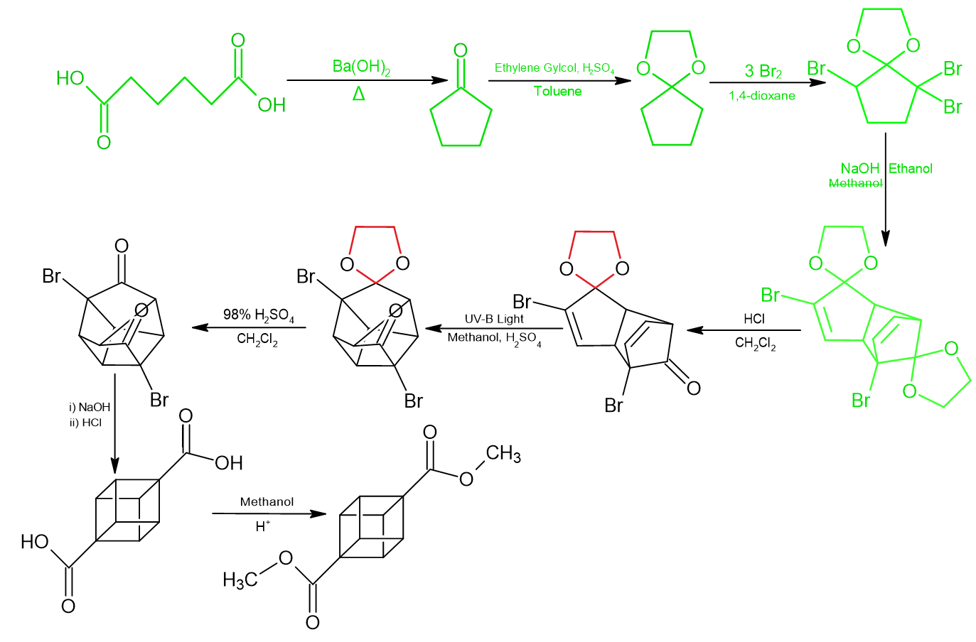

So I'm officially very invested in this project, here's my into video outlying the plan: https://youtu.be/ney-qTU3m4I
and my first attempt at making the ketal: https://youtu.be/sBA_UV15k0c
It'll be nothing new to you Tsjerk, or anyone following this thread closely. Looks like i've made a lot of mistakes too... aldol condensation...
ethylene glycol-toluene azeotrope (I hadn't thought of that, that explains what I was seeing in the dean Stark I think!).... but isn't everything so
much easier with hindsight! Hopefully the next attempt will be much more refined.

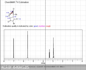

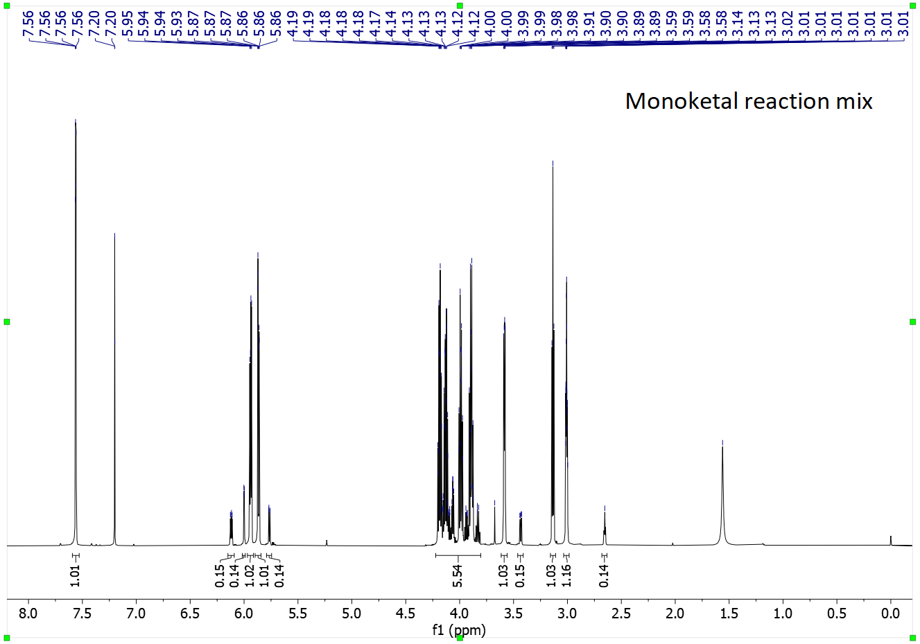

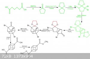

Help with NMR spectra
Hey everyone!
So I'm still working on this project, you might have seen my videos on Youtube already but I'll link the series: Cubane Youtube playlist
It's been a lot of fun so far, and I'm up to the deprotection/de-ketalization stage. Rather than removing both ketal groups in one step as per the
reference at the start of this thread, I'm intending to deprotect only one side of the molecule. See the reaction scheme. This apparently makes the UV
photochem step cleaner, which is looking like the biggest hurdle of this reaction scheme, so any help there is important. This comes from "CUBANE
DERIVATIVES FOR PROPELLANT APPLICATIONS" (1989).

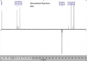

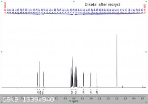

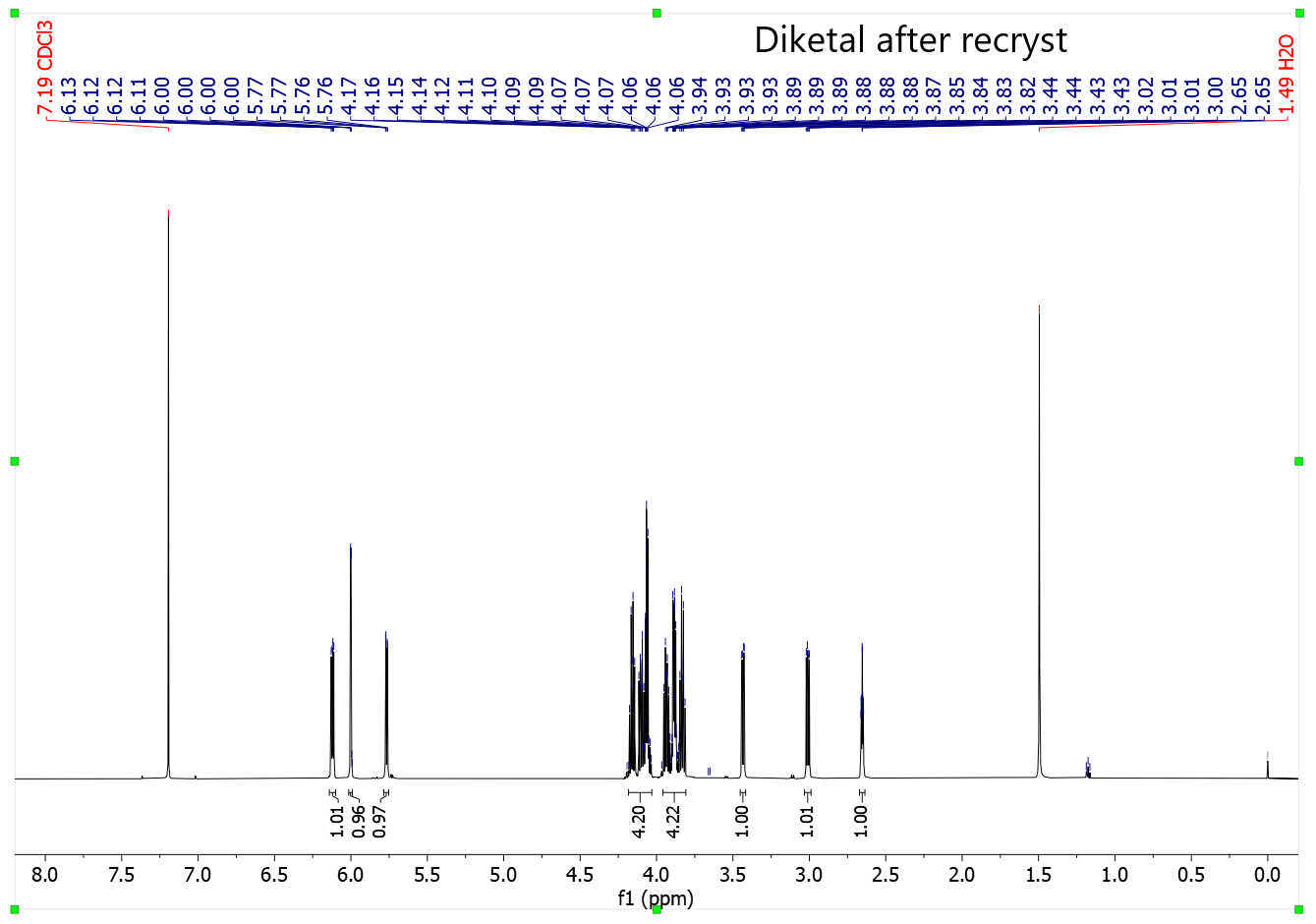

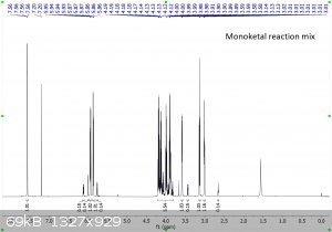

So I tried the step, ended up with some powder that looked like my starting material after 9 hours of reflux. Recently however, I got the opportunity
to send some samples off for NMR analysis! I sent the diketal starting material (from the end of Episode 7) and some material from the deprotection
reaction pot (End of Episode 8)
It's been a few years since I had to do NMR, and even then I wasn't very good at it.... so sorry for the multiple pictures, but is the following
interpretation correct?

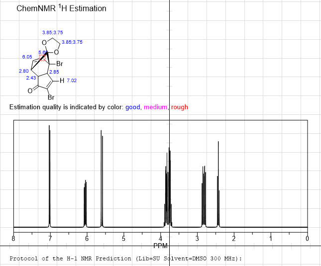

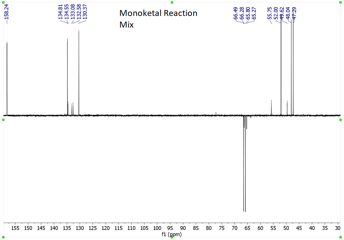

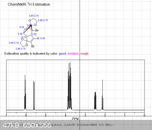

"Using the 1H peak integration, the monoketal reaction mix is 15% diketal and 85% monoketal, with no traces of the fully deprotected product?"

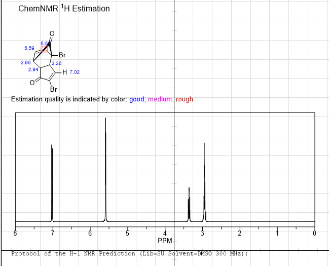

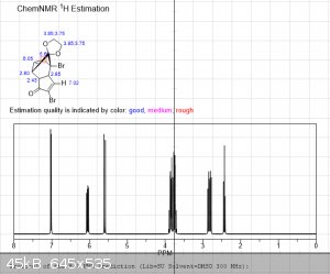

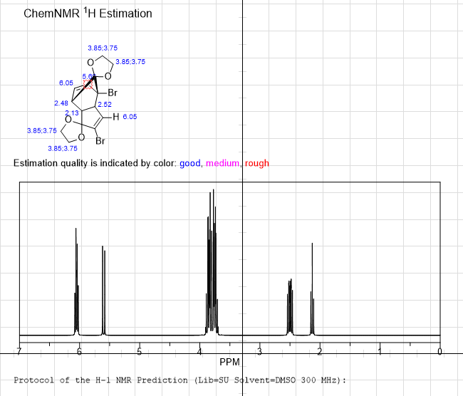

The first 3 images are NMR predictions of the NMR spectra of the diketal, monoketal and fully deprotected molecules. Thanks!
![image (1).png - 41kB](http://www.sciencemadness.org/talk/files.php?pid=655968&aid=87148) ![image (2).png - 45kB](http://www.sciencemadness.org/talk/files.php?pid=655968&aid=87150) ![image (3).png - 47kB](http://www.sciencemadness.org/talk/files.php?pid=655968&aid=87152) ![Mono ketal HNMR.PNG - 69kB](http://www.sciencemadness.org/talk/files.php?pid=655968&aid=87154) ![Di ketal HNMR.PNG - 59kB](http://www.sciencemadness.org/talk/files.php?pid=655968&aid=87156) ![Mono ketal C13NMR.PNG - 50kB](http://www.sciencemadness.org/talk/files.php?pid=655968&aid=87158)
Tdep
Posts: 516

Metacelsus
Posts: 2537
Registered: 26-12-2012
Location: Boston, MA
Yeah, so going by intergration it looks like the ratio of diketal : monoketal is roughly 0.15 : 1.03
Which is a molar percentage of 13% diketal. The mass percentage will be a bit higher because of the higher molecular weight.
I wouldn't be sure that there's "no trace" of the fully deprotected product; there are a few very small peaks that could be it. You should try to find
a literature spectrum for the fully deprotected product so you can compare.
edit: also, as you can see, "ChemNMR estimation" is terrible for stuff like this. It's possible to make better estimations using QM software like
Gaussian, but this can be a bit tricky.
edit edit: also I'm a huge fan of your channel and I'm very impressed by this project!
[Edited on 2021-3-7 by Metacelsus]
Tdep
Posts: 516
Thanks mate!

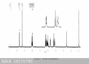

Quote: Originally posted by Metacelsus ![](images/xpblue/lastpost.gif) |
Because I'm not super familiar, what sort of statement could I make about the purity then? Just in a sort of handwave-y way. Less than 5% of other
products? Or it's impossible to say?

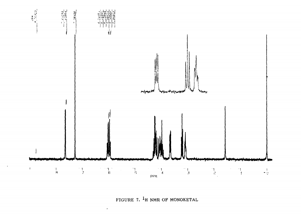

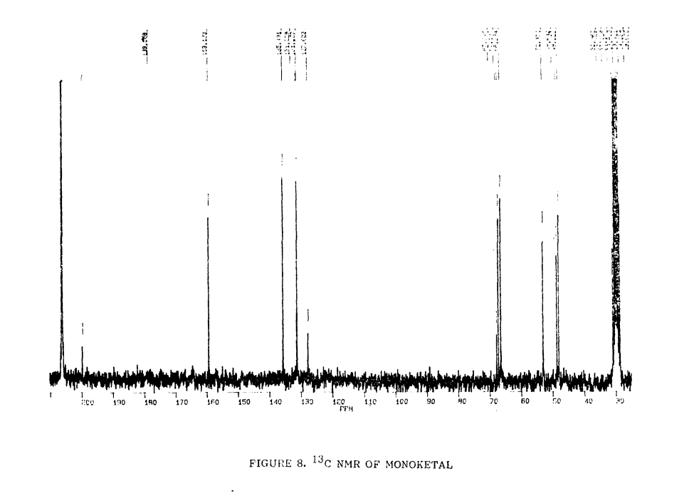

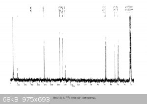

Yeah I haven't found one for the fully deprotected one. There's some reference stuff from the 1989 paper for the diketal and monoketal, although it's
a scanned copy so the quality is pretty awful. But there's nothing in there that doesn't match to my spectrum
![reference Mono ketal.PNG - 62kB](http://www.sciencemadness.org/talk/files.php?pid=655975&aid=87166)
Metacelsus
Posts: 2537
Yeah it's certainly less than 5% fully deprotected product. It looks to me like less than 1%.
Assuming your product is free of inorganic salts, it's almost entirely monoketal and diketal. There is also a bit of water too, but sometimes that's
from the NMR solvent not being dry and not from your product, and I can't tell in this case. I also think I see some DCM around 5.3 ppm.
Tdep
Posts: 516
Thanks a lot. Yeah the reaction was water and DCM, so no surprise that they show up, good spot with the DCM! But very cool. I'm amazed the products
have come out so clean honestly. I've sort of been fumbling along and for the products to be 99%, even with all the possible isomers and impurities is
sensational to see!
