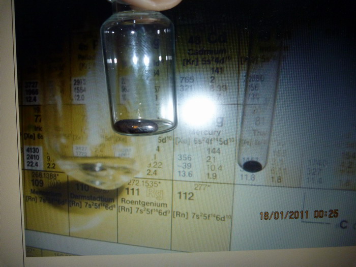

Speaking of thermometers... Mine just broke! The stupid o-ring that was holding it somehow expanded. I hear a thud, snap, and it fell right into the
boiling flask... On the bright side now I have some mercury? Gotta order a new thermometer, guess I should invest in a thermometer clamp as well.
[Edited on 18-1-2011 by smaerd]

Mine has done something similar.
At one point, I started undoing it before removing the adaptor and it fell into a 600mm vigreux column, snapping one of the pins off.
I had that thermometer for many years and many experiments after, but it developed a split in the column; a big one. I tried freezing it and vibrating
it back into a solid column then, on closer inspection, found a hairline crack in the bulb. So that was the end of it's life and, like you have there,
I have a little blob of mercury to remember it by.
I found an old, plain test tube and siliconed it in there to amuse people with - as most people born in the last few decades haven't ever seen it in
person, and it is a very odd thing to look at and feel sliding around in the tube like liquid lead. People always want to play with it when I put it
in front of them.
Point being, you're not the first person to manage that (I know at least one other guy on here, besides myself, has done it recently).
Some lessons you only learn through experience!
[Edited on 18-1-2011 by peach]

@peach : Awe man if it took out my vigreux I'd be very upset(esp a 600mm one). Sounds like I got away from this pretty clean. RIP to our thermometers
hehe. Served us well. Your right this mercury is pretty neat .
Besides this give me an excuse to have a thermometer clamp.
WAIT? Is that your picture or did you digitally modify mine? haha edit - oh I get it you took a picture of your Hg sample overtop of your screen haha.

I see your mercury and raise you more mercury.
