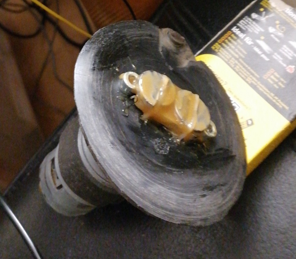

Magnet stirrer broke needed a quick replacement.
Motor is from a battery lawn trimmer - complete overkill but due to its mass it needs no big balancing. Magnets are Sm/Co - I had too many Neodyms
dying already.
Not shown is the lab-power supply I use now, I will later use a 14V PS and a 5 buck speed controller (PWM). It pulls now in the worst case 1,5 Watt.
Changes I would make now: Magnets a bit more apart like 5 mm.
It is perfect and powerful with RBFs and eggs.

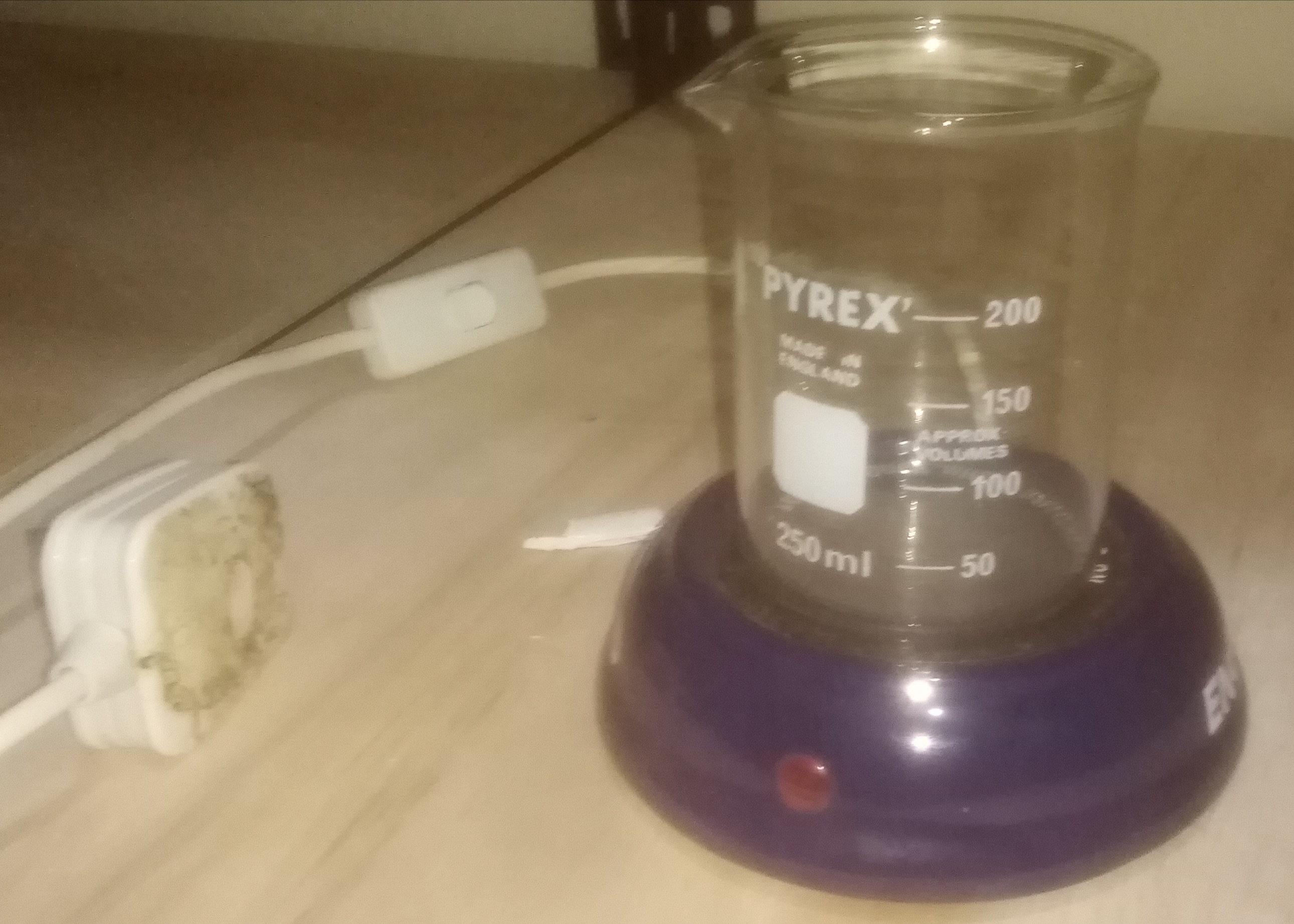

Coffee cup warmer for evaporation.
I've recently been evaporating dilute nitric acid solutions to recover solid residues,
I've found this coffee cup warmer to be very useful,
It maintains a temperature of about 85C and can be left on for as many hours as desired.
I've left it on overnight several times.
(outdoors; a covered, ventilated, tiled area - no hazards)
I think that coffee cup warmers have been mentioned before,
but I found it so useful that I've mentioned it here again.
Also useful for recrysalisations.
