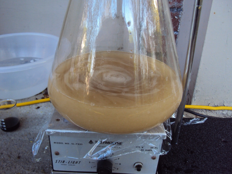

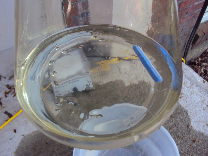

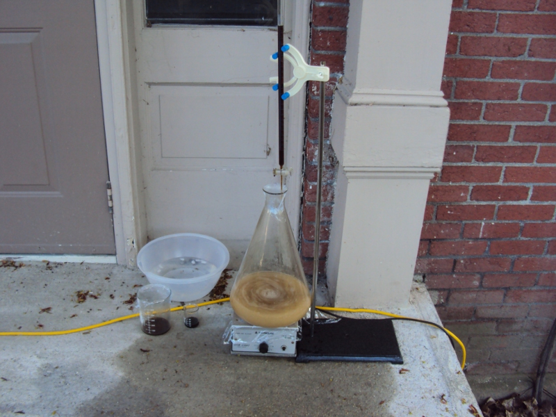

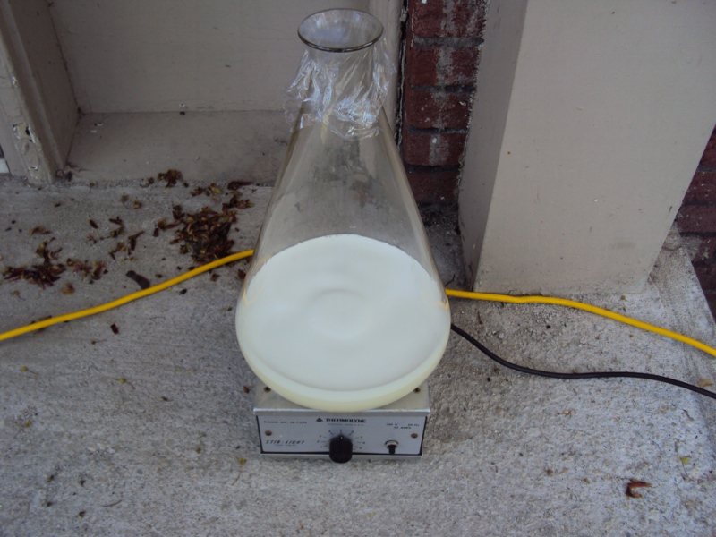

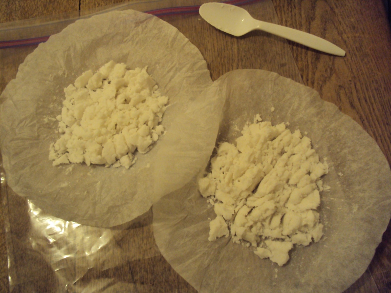

Hydrazine Sulfate Synthesis
I made Hydrazine Sulfate again last week and never got around to posting the few pictures I took. I used Rosco's method in general. I find the process to be quite robust as I didn't follow all intructions exactly as outlined in the procedure (because of lack of time and laziness), and still got 81.5g of Hydrazine Sulfate for a half batch. I think my yield has a lot to do with my reagents (probably the hypochlorite), because the first time I made HS I got a very similar yield and I was extremely sloppy. This time I was much more careful (relatively) to temperatures, reactions time and addition rates.
Anyway here are a few pictures. The gross brown color is from the black drain cleaner I used to do the final neutralization and precipitate the HS. The brown color pretty much completely washed away when washing the HS with 70% isopropyl alcohol during filtering/washing.
The first picture was taken sometime during the first 10 minutes, notice with my reagents I have very little foaming. The second picture shows the end of reaction, very pale yellow color. BTW, that is a 5L erlenmeyer, and a 3" stirbar. The third and fourth show the final neutralization with H2SO4. The last shows the damp yield. The dry yield taken a couple of days later was measured as 81.5g.
I should have gotten a picture of the primary neutralization with HCl, it was very neat looking, but I forgot to take a picture. A hotplate-stirrer was used between the first and second pictures, but I forgot to take a picture of that part of the process. The only thing I had on hand to do the acid additions with was a 25mL burette, so I had to top up the burette quite a few times, not ideal.
Initial Reaction.JPG - 231kB Reaction Completion.JPG - 235kB Acid Neutralization.JPG - 264kB Acid Neutralization close-up.JPG - 245kB Damp Yeild.JPG - 229kB
[Edited on 29-5-2011 by Hennig Brand]
