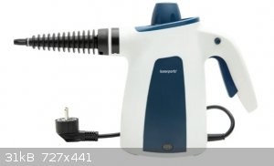

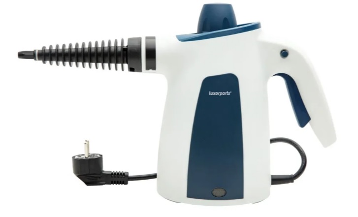

I just have to ask you all, something that came into my head when browsing a store.
Can these steam cleaners (see pic) be used as a steam source when you want to steam distill something?
I have never tried one of these so im not familiar with them.
If one would just connect a short hose at the steam outlet and connect other end to a glass tube that is inserted into second neck of a reaction flask
with the glass tube reach into the bottom of reaction flask, submerged into the liquid.
Then just start the unit and top it up with distilled water when needed.
Would this work, or is the steam from these units not good somehow?
It seems much easier than to set up a steam generator in the usual way.
Any thoughts on this?

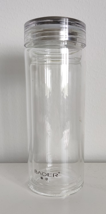

An all-glass vacuum flask, great for recrystallizations.
Belowzero
Posts: 173
Registered: 6-5-2020
Location: Member Is Offline
This needs a little more explanation, what is the intended use for such a flask?
Fyndium
Posts: 1192
Registered: 12-7-2020
Location: Not in USA
It is sold as a thermos flask, but it's just made out of glass. Older ages flasks were made of glass, but as people mishandle them, they will break,
so they were superseded by SS flasks.
No other, but slower thermal gradient will allow for bigger crystal growth without using insulated vessels, and it is visually more appealing as it's
transparent. Also, some stuff react with stainless steel, so no issue here.

Quote: Originally posted by Mateo_swe | I just have to ask you all, something that came into my head when browsing a store.
Not really. Those devices do not generate a continuous flow of steam, and need time to boil the next portion of water after about 20 seconds of use.
This thing is, sadly, useless for anything except for cleaning bathroom tiles.

Thanks Konductor
Good to know these cleaning vacuum devices dont produce a continuous flow of steam.
Now i can forget that idea and focus on other things.

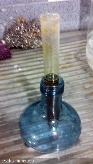

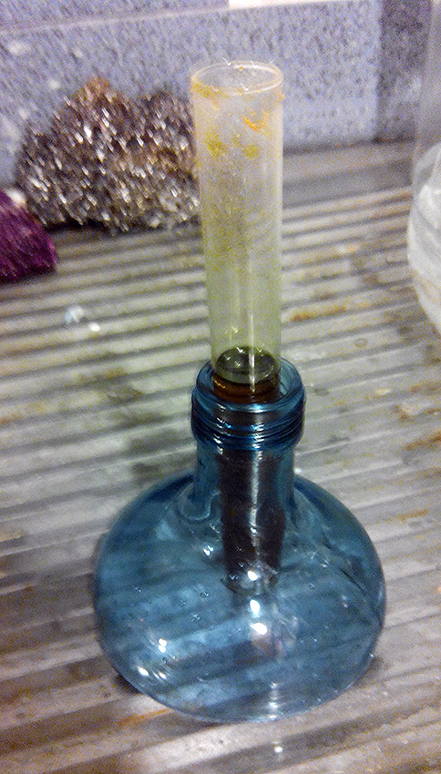

I won't put up a picture. But I had a coffee maker that went kaput, and what I did was use it as a makeshift filteration apparature. I put a pair of
funnels where the coffee filter used to go to let as much space for my carafe. It isn't 100% borosilliciate glass, but it does handle boiling water
very well for obvious reasons. It also holds more than 1 liter of water, which means I can normally filter and clean everything before having to treat
the water and pour it down the drain.

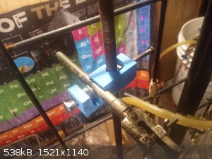

Ummm. My Ringstands finally got built.
Ten pound, Cast iron, weight plates, strongly resisted being drilled. My High Speed Steel, Drill Bits, just couldn't drill the required holes. The
plates, of unknown, scrap origin, just couldn't be drilled. Too hard.
I finally bought a set of Stubby Tungsten Carbide Drill Bits. The 6mm Carbide bit, produced a hole, approximately correct for my purposes. Easy
peasy. The holes were a little large but tap-able. I just stuck a 1/4 inch, 20... Tap into the chuck of my drill press, and I turned the chuck by
hand. A few stainless steel bolts to attach hardware and Bingo! Heave duty ring stands.
If you have the weight plates, it's an easy build.
Just bolt your threaded end plates to yer weight plates, and screw in 1/2 inch copper pipe,

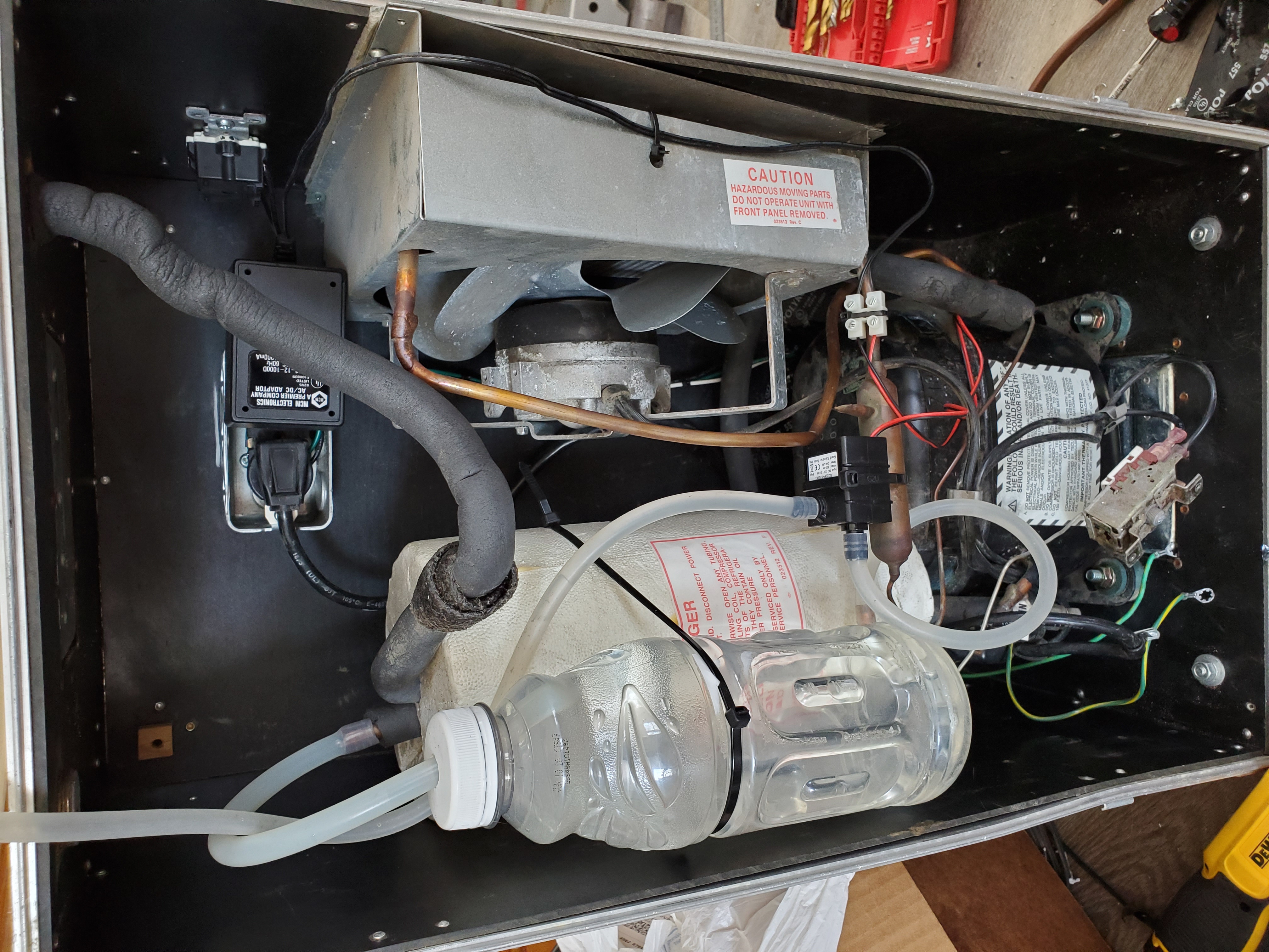

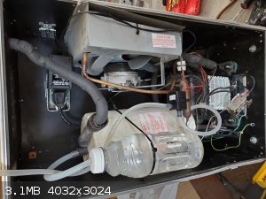

Water chiller
Here is a chiller I made from a water fountain I found in a dumpster. I used a cheap 12v pump and a juice bottle as a reservoir to make a closed loop
and it stays around 5⁰C. I mounted it in a box on wheels so it's real easy to move around. I have since insulated all the tubing and put a guard
over the fan.
[Edited on 8-30-2022 by Gammatron]

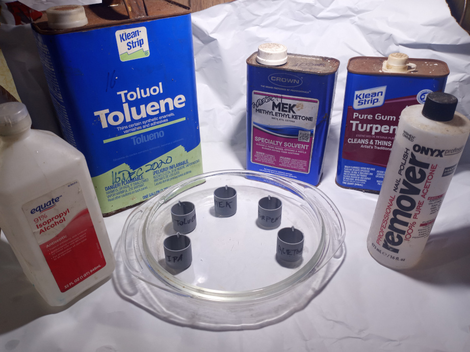

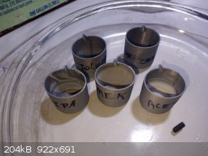

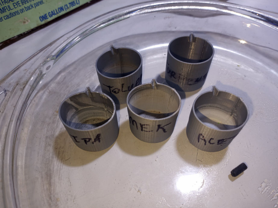

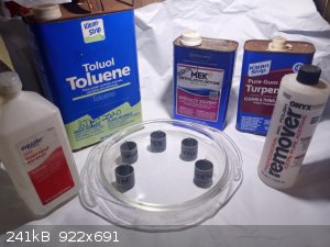

Bought a 3D printer earlier this year, and I love it. Lately,I have been doing some preliminary investigations on the chemical resistance of
polylactic acid (PLA)filament. It's actually amazingly durable.
This first round, I printed five little beakers with grey Sunlu PLA+ filament. Wall thickness of 1mm. So far I've exposed them for an extended (24+
hours) period of time to:
Acetone
IPA, 91%
Toluene
Methyl Ethyl Ketone
Turpentine (the real stuff)
I would have bet on failure from the turp, tol, and MEK, however, only obvious damage was "leakage" of turpentine. No melting or deforming of the
plastic with any solvents checked so far, only a bit of "whitening" after evap of the solvents.
Be interested to see how this stuff stands up to acids and bases; but at this moment I wouldn't hesitate to use this stuff for things like funnels and
what not.

I haven't done any rigorous chemical testing on PLA but the only one's I've come across so far that destroy it are sulfuric acid and DCM. I have found
it to hold up well against hydrocarbons, curious if it could withstand gasoline though.
[Edited on 9-28-2022 by Gammatron]

From the mix of solvents I exposed it to, I think PLA+ would probably be OK with gasoline for quick things like funneling. Wouldn't want to STORE
hydrocarbon solvents in it. I'm curious about bases though, as I've seen ammonium hydroxide solution fuck up some PET.
I've got a variety of liquid acids to throw at it too:
Formic
GAA
HCL
Sulfcuric
Nitric
Gammatron
Posts: 125
Registered: 30-8-2022
Location: Abandoned Uranium Mines
Hmmm yeah I wonder how it'd hold to NaOH, especially if hot. And given the effects I've seen with H2SO4, I would imagine most strong acids would
attack it. Definitely do some more testing and let's us know!

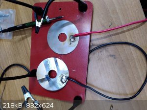

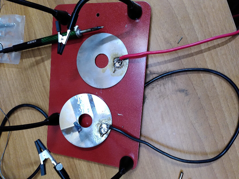

supposedly HDD platters are made with a Pt alloy coating them i'm gonna test mine by using them in a hypochlorite cell
i was experimenting with soldering wires directly to the platter rather than just clamping on to them,
they seem to be coated in a thin non metallic or oxide layer but brushing that off with a scotch pad left me with a mat surface that readily bonded to
the solder.
now to finish building the rest of the cell

I'll be interested to see how that turns out, I have a bunch of those and old HHD's are cheap too.

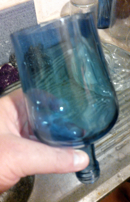

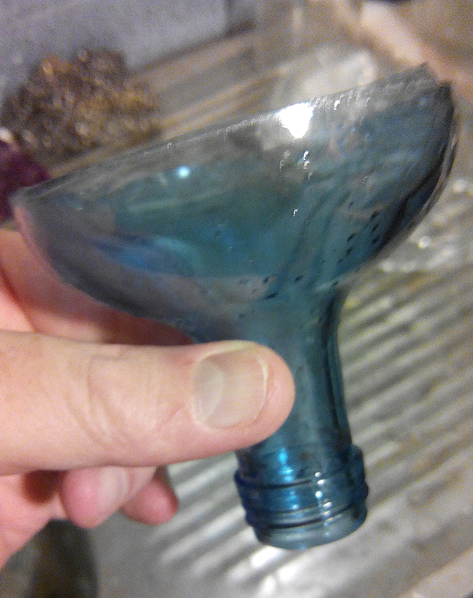

Bottle cut: I use for a test tube stand & for dust funnel :-)
Any size, any mouth diameter...
smooths the corners to prevent cuts.

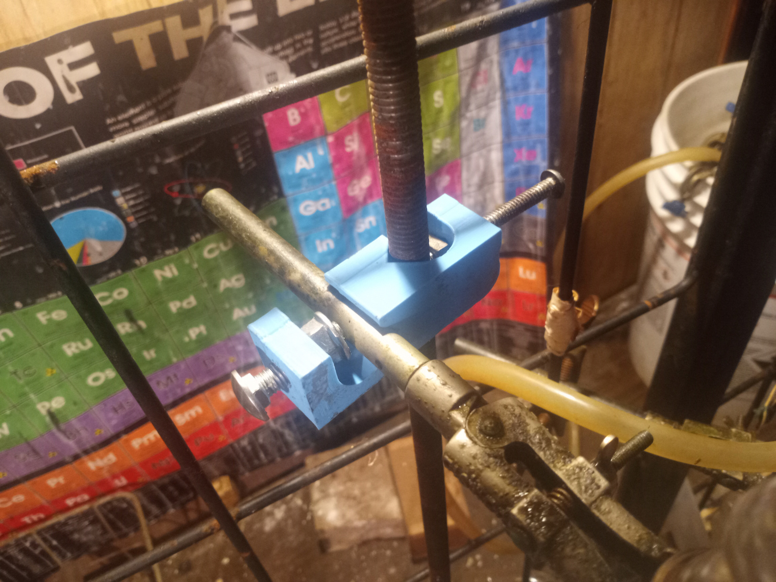

3D printed PLA Bosshead
Running trials (so to speak) now. Generic PLA, 50% infill (gyroid)
[Edited on 11-30-2022 by arkoma]

Quote: Originally posted by Gammatron | Here is a chiller I made from a water fountain I found in a dumpster. I used a cheap 12v pump and a juice bottle as a reservoir to make a closed loop
over the fan.
[Edited on 8-30-2022 by Gammatron] |
Now this is quite impressive! What do you use as the coolant? Do you have the ability to control the temperature?
Gammatron
Posts: 125
Thanks! There is a thermostat which I have set to the lowest temperature but I found that If I bypass it I can get below 0⁰C so I bought some
electronic controllers so I can just set the temp to whatever I want. I use antifreeze for coolant.
