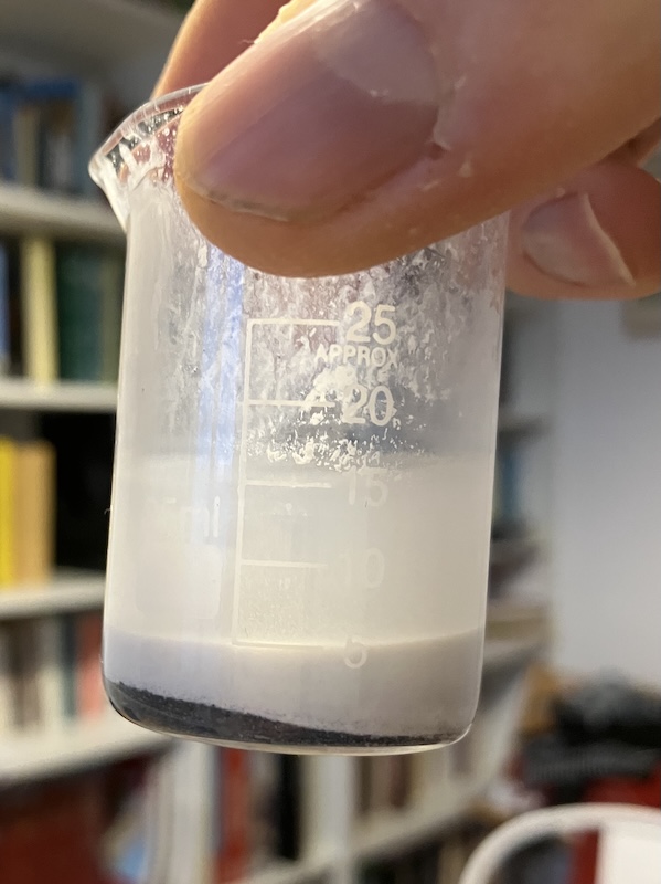

[*] posted on 9-12-2024 at 07:54
Has anyone ever attempted the aqueous reduction of potassium nitrate by zinc?
I have, and it seems to work (I’m sure I obtained a yield > 50% – see the attached picture where the upper layer in the beaker is zinc oxide) but it seems also to be heavily dependent on the quality of the zinc (I used scrap battery zinc that I activated by passing two minutes in 23% HCl), which in my case seems to vary from batch to batch. The zinc/potassium nitrate mix, to which a tiny amount of copper sulphate can be added to further activate the former, must be heated up to at least 70/80 °C for the reaction to take place, but there’s no need for higher heat or crucibles.
IMG_2937.jpeg - 113kB

[*] posted on 9-12-2024 at 12:59
Keras.
The reduction with ammonia solution would be better.
[Edited on 9-12-2024 by Alkoholvergiftung]
50g KNO3 in 150ml water. + 350ml ammonia solution desteny 0,96.
Addition under cooling 60g Zinc powder. Temperature must between 20- 25C after 45 minutes reaction is compled.
60g Potassiumnitrate the 50g are for Sodiumnitrate
[Edited on 10-12-2024 by Alkoholvergiftung]

[*] posted on 9-12-2024 at 23:40
Then I suppose you filter and boil the filtrate to get the nitrite?
Alkoholvergiftung
Posts: 198
Registered: 12-7-2018
[*] posted on 10-12-2024 at 00:28
yes. But add slowly the zinc powder and the temperature must be hold between 20c and 25c. because if you do it fast the nitrate get reduced to KOH and ammonia Gas and thats an fast reaction the mix boils over like an mentos in an Fanta. May be with higher chain alcohols you can fall out the nitrite.

[*] posted on 19-12-2024 at 07:45
the Temperature is to high old process sayed never over 50C newer one sayed not over 25C.
Okay. So I bought a bottle of 13% NH₃ (d = 0.95) in a convenience store and tried the process with weights and volumes divided by 100. It definitely works. However, I couldn't reach a ‘klar Flüssigkeit’. I had a lot of zinc oxide in suspension (see picture), and I stopped the reaction when it seemed to me all the zinc had reacted. The few spots of zinc you see spattered in the white powder are zinc which had stuck to the stir bar.
The titration I did next was not very conclusive. I missed my first one, because I failed to take into account that the excess ammonia would neutralise the few drops of sulphuric acid I had used with the permanganate. I then redid it with a large excess of acid. The yield was probably around 65 to 70%, which is not bad, given that I really eyeballed it (~6.5 mL where 100% would have given me 4). Must have been mechanical loss in the filtering and my process was very rough anyway.
It may be worth trying with 10x more reactants. Will do that if I have the time.
[EDIT: Ooops forgot to attach the picture! This is A 25 mL beaker btw]
IMG_2974.jpeg - 1MB
[Edited on 19-12-2024 by Keras]
