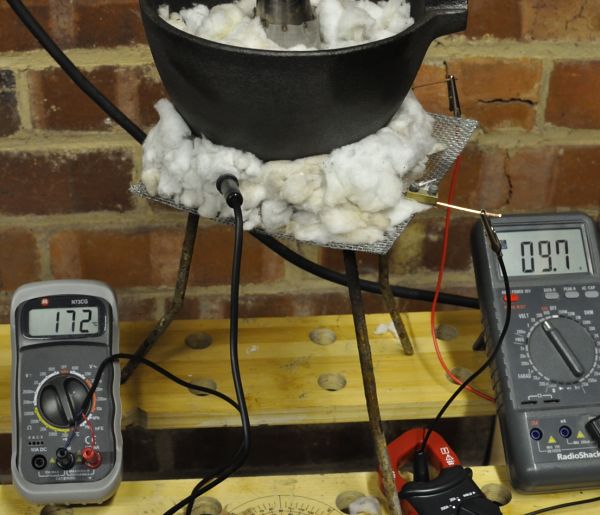

Cathode etc. installation:
![Na_004.JPG - 45kB](http://www.sciencemadness.org/talk/files.php?pid=258127&aid=19948)
Fire cement used here - the only real weak point where the molten alkali could spell the end for my cell. Having previously fired it using a
combination of a hot oven, blow-torches and plain old wood fire, I've elected to use a more controlled process this time.
A U-tube of 8 mm diameter 0.6mm wall copper tube was formed and a tightly wound coil of NiChrome wire fed through, wrapped with a spiral of glass
fibre weave for electrical isolation. You can see the firing set-up for setting the mesh in place below - voltage, temp and current (just off shot)
being monitored on separate meters. The second shot shows the cathode firing set up, and the now heavily oxidised copper U-tube more clearly. Voltage
is controlled accurately by an 8 A variable transformer (off-camera), but could just as easily be controlled by the circuit from linearly variable
heat gun on a budget. Ceramic wool is used to thermally insulate the set-up.

having on the cement...
![Na_016.JPG - 21kB](http://www.sciencemadness.org/talk/files.php?pid=260051&aid=20262)
Length of operation estimated at 2.5 hours given the timestamps on photos. Current is unknown as the actively cooling case I built around my PSU
prevents access to the appropriate wires; a built-in ammeter for the next upgrade, I think. On the topic, the cooling was achieved by encasing the PSU
in a long rectangular wooden box, open at both ends, with a microwave fan wired in at one end - very simple and effective.
Results:
![Na_020.JPG - 12kB](http://www.sciencemadness.org/talk/files.php?pid=260051&aid=20270)
Sodium was collected with disposable pasteur pipettes, which worked about half the time; the other half of the time, the sodium froze in the glass.
The first photo is the metal I managed to pipette out, prior to purification. The second photo was taken during purification of the material which
froze in the pipettes, these having been crushed and heated under oil.
Findings and learnings:
I still don't like sodium hydroxide, particularly not molten and especially not at these volumes. I can echo the sentiments and findings of others; it
fumes and spits, gets everwhere, and is generally unpleasant to work with. I'd previously oven baked about 1 Kg of hydroxide to remove any water, but
had to add another 0.5 Kg, un-dried, to fill the cell. Some significant foaming during the first 15 minutes of operation could probably have been
avoided had the entire quantity of salt been thoroughly dried.
My cell was not insulated well enough / delivering enough current to maintain temperature without external heating. Unfortunately the nichrome broke
about half-way through the run; a stray piece of hydroxide lost during filling having acted on it I suspect. Still, the cell carried on whilst very
slowly losing heat, and actually seemed to become more 'sedate' (if one can apply that word to such an experiment) at lower temperatures, i.e., just
above melting point.
Coalescence of the liquid sodium during purification under oil was far easier with the broken glass present, and I observed that lumps of alkali
impurities appeared to help more so. Perhaps a simple physical effect of helping to break the surface tension - could be replicated with unglazed
ceramic maybe?
Next steps:
Yield:
For this I intend to coalesce the entirety of the metal into one ingot under a suitable solvent; I have mixed xylenes on hand, with b.p. 140 °C, so
figure this could work under reflux, providing the beads will come together.
Disassembly:
I've washed the cell out and it's going to come apart so I can fully assess the damage from the operating conditions.
Downs cell:
I intend to trial this option using my, now empty, argon canister as a crucible. I likely have enough sodium to build a β-alumina cell but would
be more comfortable with an additional batch, and I'd like to have personal experience with all three methods to make a fair comparison.
Further update soon to follow...
[Edited on 23/9/2012 by Dave Angel]

Thanks, Bromic! This one has been on my to do list for so long and it feels great to have finally cracked it, particularly since Davy
was isolating his sodium, oh, nearly 200 years ago...
Based on cal's post, I've elected not to use xylene for purification:
Quote: |
Although it is often suggested that prior to use sodium be cleaned from the adhering oxide/hydroxide crust by remelting and rolling under xylene [1],
the evaporation rate of xylene above the mp of sodium has been found to be too high, and xylene is not very effective in removing the oxide crust. On
the other hand, the bp of xylene is still high enough to present some removal problems, and it is unsuitable for long-term sodium storage because
sodium rapidly oxidizes under it. In this respect, paraffin oil is superior. |
So instead, I've today invested in some baby oil (Johnson's). This contains mineral oil for the most part, and some isopropyl palmitate and fragrance,
though likely not much given how stingy such companies are with their ingredients. Anyway, this will suffice until I can get some pure mineral oil.
I had been using '3-in-1' brand oil for purification, but this seems to lose its lighter fractions and thickens up considerably, plus I'm not sure
what sort of additives might be in it. Additionally, I stored the sodium under kerosene (Bartoline brand 'paraffin', from B&Q) overnight and
observed a layer of red powder over the exposed material this morning, so clearly something is reacting - again, unsuitable.
Coalesence and purification complete:
![Na_025.JPG - 21kB](http://www.sciencemadness.org/talk/files.php?pid=260100&aid=20282)
The ingot weighs ca. 14 g (I don't trust the decimal point on my balance - it's time for a new one) so I'm quite pleased with that for a first
attempt. I actually found (obvious in hindsight) that the coalescence works best as the sodium is solidifying; holding the beads at melting point and
then cooling whilst gently stirring brings it all together nicely. Its behaviour reminds me of solder...
I've also partly dismantled the cell. The anode coil came away from its fixing as soon as the cell was washed out, and it's evident that it was in
contact with the gauze at some point - I imagine towards the end of the run, when there seemed to be something amiss, with some popping / small
explosions. This, along with the temperature drop, is what ultimately led me to end the run. Additionally, the alkali has managed to (as feared) eat
quite heavily into the fire cement at the base - it did not take much to remove the gauze, so it looks like 2 - 3 hours is about as much as one can
get out of a reasonable quantity of the cement used (KOS brand, black). Also, the plating on the cathode seems to have been breached, as evidenced by
the rusty marks on the tip, but I have not yet attempted to clean this up to see if it's just iron oxide that's been splashed on the top, or actually
from the cathode itself - the plater did warn me that the coat would be thinner there.
![Na_023.JPG - 30kB](http://www.sciencemadness.org/talk/files.php?pid=260100&aid=20278)
With some refitting using the learnings above, this cell could be made sturdier and deliver a significant run. However, given the unpleasant
experience that is working with molten alkali, I'm shelving this design for now. Looking at the Downs cell, the first thing that comes to mind is the
need for a PSU rewind for higher voltage; 7 to 8 V for an effective process vs. my 5 V used for Castner... Already started working on the cell's
melting pot but that's a post for another day ![:)](./images/smilies/smile.gif)
