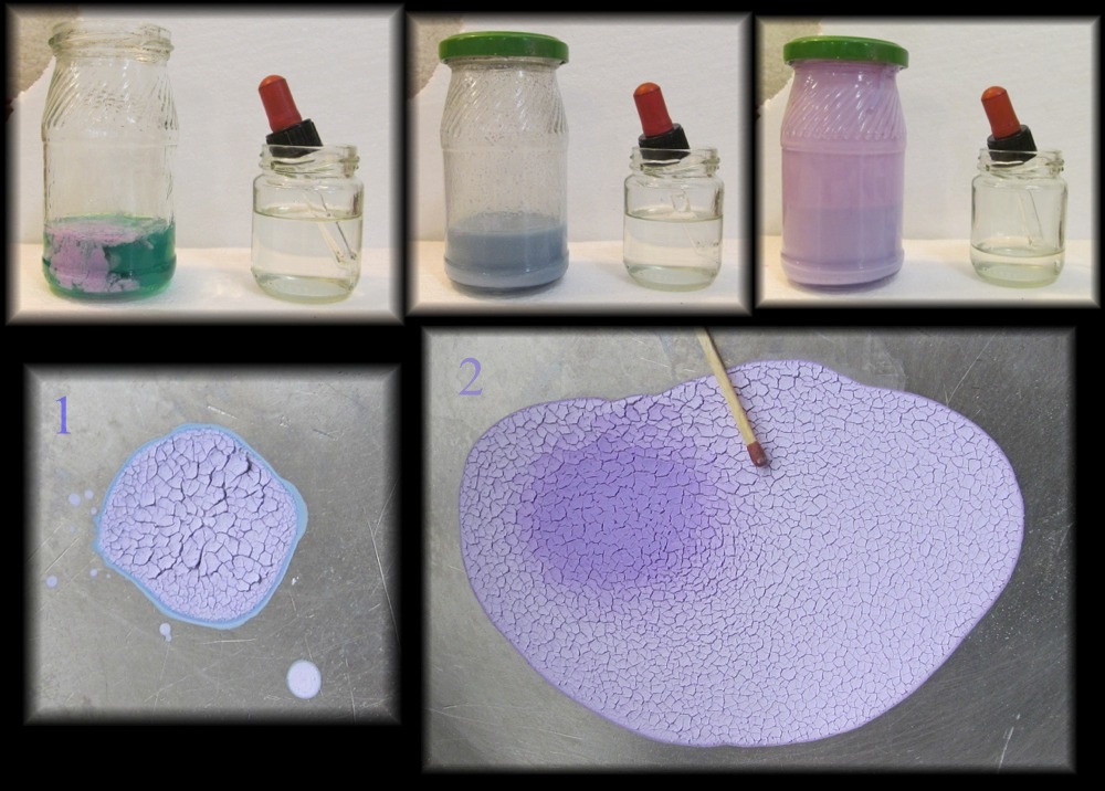

So I tried the synthesis of NHN and I got a blue precipitate. However it did not change lilac purple, but instead stayed blue, even when I agitated the solution a bit and added more of the nickle nitrate solution. I'm letting it dry now, but its still not changing. Is there a reason for this odd/out of place color?

Will be better added hydrazine, not NiNO3. Small amount hydrazine = blue. Surplus Hydrazine = lila. If you has pure materials. If you has Hydrazine and NiNO3, is impossible any another reaction. Arises NHN. In a small surplus hydrazine hydrate. ...LL..:cool:

Yes LL is right!
When adding Ni(NO3)2 to N2H5OH at first without agitation you get locally a blue flocculating precipitate (where the green concentrated drop of Ni(2+) crashes to the bottom of the beaker...
When you mix it, it turns lilac pink with the surrounding exces of N2H5OH.
--> You had too much Ni(2+) and too less/not enough N2H4.
Meaning you have transition/uncomplete complexation like Ni(N2H4)(NO3)2, Ni(N2H4)2(NO3)2 and maybe traces of Ni(N2H4)3(NO3)2 ...
But not plain Ni(N2H4)3(NO3)2.
[Edited on 14-6-2016 by PHILOU Zrealone]

Ah, this actually makes sense, on a second attempt I noticed it was lilac purple for a bit, then turned blue and stayed that way. When this precipitate was dried, I found myself with a substance that did not burn very well, but surprisingly made a nearly unnoticeable popping sound when confined. I will try again tomorrow and do the reverse by adding the hydrazine to the nickle nitrate, and add it in greater quantity (though I'm trying to keep things very small here, for obvious reasons).
I will report back here with results in a few days, thanks!

NHN
Well, here is difference between not complete reaction (1) and result complete reaction with surplus hydrazine (2) Use HH 80%....LL...:cool:
nhn.jpg - 323kB
