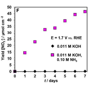

Am I reading this correctly? The yield is about 50 micro moles per square cm per week.
So, with a 10cm by 10 cm electrode you would get less than a quarter of a gram of nitrite per week.
Graph.png - 39kB
That's with 0.1 molar ammonia, i.e. 0.17% w/v. I suspect a more concentrated solution would result in better yields.
[Edited on 22-8-2023 by Lionel Spanner]
