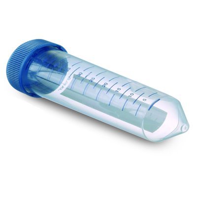

For you biochemist over here, one of these makes a really good adjustable dropper. Make the smallest hole possible in the conical bottom using a hot needle, adjust by screwing the endcap on less or more tight. :) Dripping rates can be determined and marked on the tube.
tube_sterile_centrifuger_recolte_semence.jpg - 14kB
[Edited on 24-5-2015 by nitro-genes]
