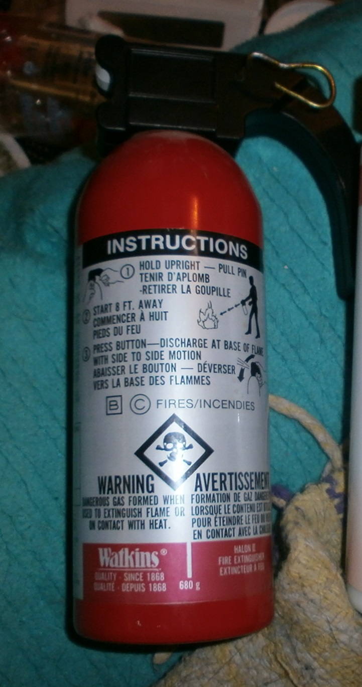

Plastic keck clips, understand fire extinguishers
During a nitric acid synthesis the plastic keck clip holding my condenser to the clausin adapter cracked. New hot nitric acid dripped into the
mineral oil the boiling flask was submerged in and instant fire.
The fire extinguisher was right at hand and the blaze was out in less than ten seconds.
There was 900 ml of 95% sulfuric acid in the now cracked boiling flask along with the nitrate (potassium as I recall). The hot acid and oil fumed for
more than ten minutes. The fume hood exhaust roared a bit (jet sound) and this filled my neighborhood with a dense white cloud. I was very pleased
this didn't bring a visit from the local constabulary.
Two take aways... Plastic Keck clips, never again! Ten pound fire extinguisher... much more mess than the fire! Clean up took more than a day. I am
also very careful choosing heat sources and try to avoid oils when possible.
I now use metal clips and have small 32oz sized extinguisher along with a larger ten pounder. In the case of this fire, as impressive as it was, the
smaller extinguisher would have worked fine and cut clean up in half. I only used one small blast of the that larger extinguisher and it had to be
replaced (refilling them is a hit or miss proposition in my burg).
If you haven't used a fire extinguisher, it would be helpful to at least watch a video of the one you purchased being used (or one much like it). I
was very surprised at the volume of material ejected with a small squeeze of the trigger, and the force it came out with is worth considering. This
will blow stuff around in most small fume hoods, easily blew my distillation setup half off the hot plate.
Deathunter88
Posts: 514
Registered: 20-2-2015
Location: Beijing, China
Quote: Originally posted by JScott ![](images/xpblue/lastpost.gif) | During a nitric acid synthesis the plastic keck clip holding my condenser to the clausin adapter cracked. New hot nitric acid dripped into the
will blow stuff around in most small fume hoods, easily blew my distillation setup half off the hot plate. |
Get yourself a CO2 fire extinguisher, zero residue and you almost WANT to find a reason to use it.
Today I generated several moles of nitrogen dioxide in a few minutes in a tiny makeshift fume hood. That was definitely not a very good idea. As I
stared amazed at the huge blob of brown gas sitting inside the fume hood, I decided to adjust the intake to pull out more of the gas more easily. So I
flipped the front cover open.
When your fume hood is full of nitrogen dioxide gas, do not open it.
I backed away from the horrible choking mess with my eyes burning, barely able to breathe, and the hood sealed itself. Eventually, it cleared.
[Edited on 21-11-2018 by JJay]
XeonTheMGPony
Posts: 1638
Registered: 5-1-2016
Quote: Originally posted by Deathunter88 ![](images/xpblue/lastpost.gif) | Quote: Originally posted by JScott ![](images/xpblue/lastpost.gif) | During a nitric acid synthesis the plastic keck clip holding my condenser to the clausin adapter cracked. New hot nitric acid dripped into the
Get yourself a CO2 fire extinguisher, zero residue and you almost WANT to find a reason to use it. |
I use Halon / CO2
