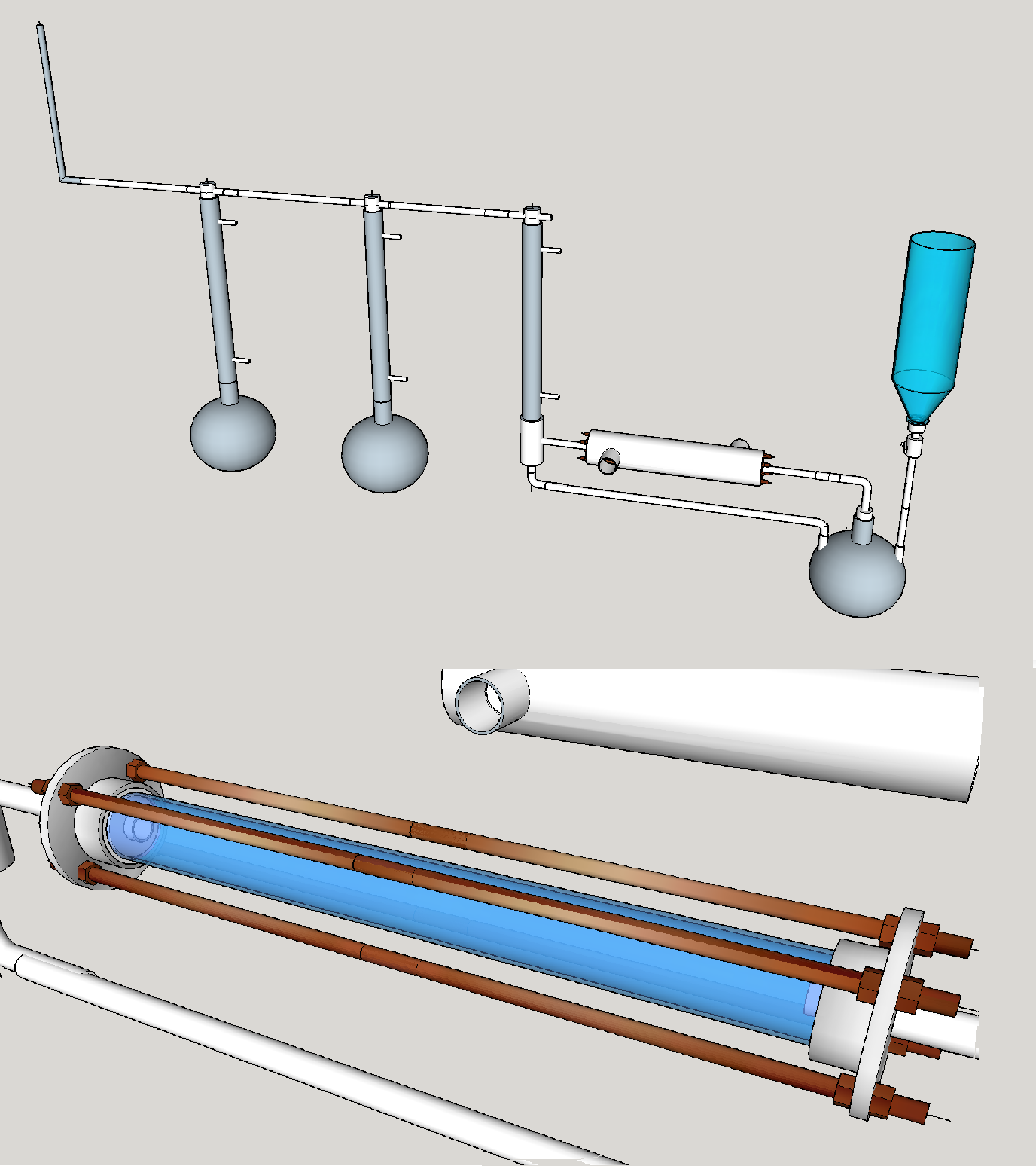

I am planning to use the apparatus I presented in acetanhydride topic. The setup is somewhat general and the operating principle is simple. The reactor could be placed vertically as well, but this way the catalyst will hold in there easier.
Unreacted methanol is always more preferable than decomposition, since methanol can be recirculated indefinitely through the bed with refluxing recirculation, but CO and H2 are total loss.

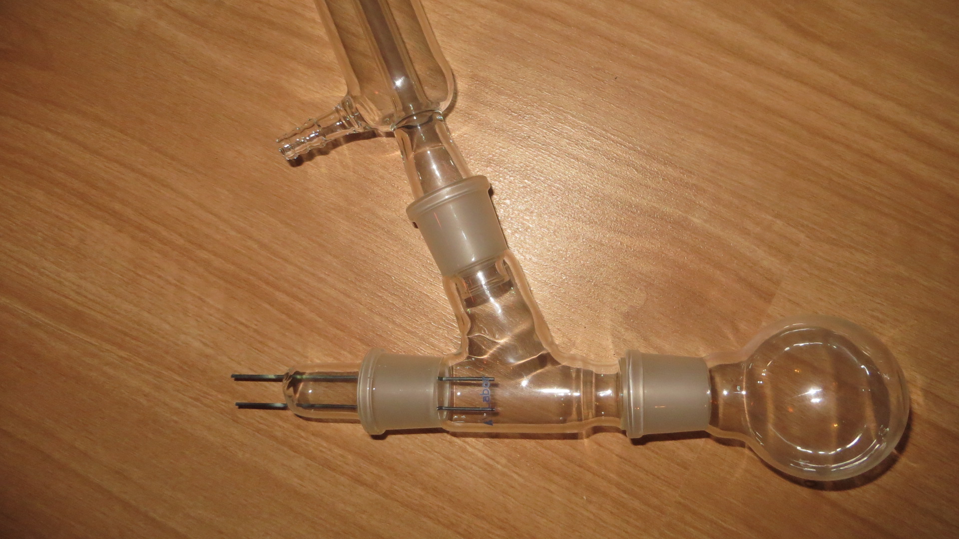

Hi folks, I custom made a new alcohol oxidation reactor, since I broke the old one (I almost cried).
I will also try to oxidize alkanes with it, C3-C6 to see what I can get, and how far the oxidation goes, hopefully not till H2O+CO2. Note that the kanthal filament will be inside the glass tube, instead of heating the glass wall, similar to a ketene lamp.

That's some nice glassware. I'm jealous!
I had always wondered what happened to you. I had followed your experiments in this thread back in the day, and tried some of them myself. I hadn't noticed your posts in the last year.
As an FYI, Teflon-insulated stranded wire uses silver-plated copper strands. I took an individual thin strand, wound it into a double-helix, and found that it didn't take too much current to get it to heat up.
I have personally gravitated towards using a tube furnace configuration with catalyst beads, since that is easy for me to build. What I have never done very well is the acetaldehyde condensation and separation from the excess alcohol. I haven't put the necessary time into fine tuning this process.
So, is the reactor intended to work horizontally? And, did you make it yourself?

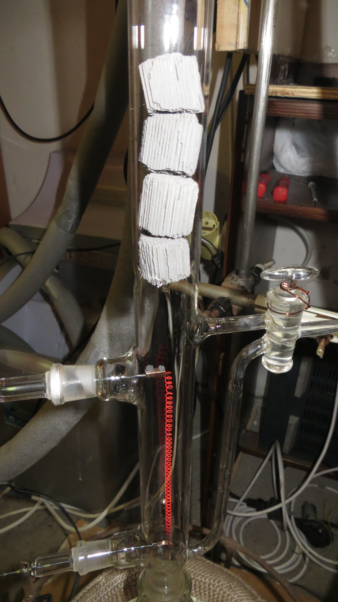

Here is the reactor in operation, the kanthal wire was brought to dull red, the gas evolution was continuous. I led the gas into ccNaOH sol, after ~10mins and orage precipitate appeared with an intense apple smell. The gas was led into 1ml of ccH2SO4 after ~15mins it charred. I did not try to isolate the acetaldehyde since it would require some -30°C temps.

That's an interesting looking apparatus, Jimmy. What is the side tap with the stopcock for?

Hi Magpie, the tap is for letting air in below or above the filament, lack of good mixing of the vapors may cause a mini explosion, that is why I still collecting some nerve to try it.
Another method would be to electroplate copper onto the kanthal and heat up the wire under liquid Et-OH itself. It would be interesting to see what happens, maybe all the heat would go into acetaldehyde synth insted of refluxing the Et-OH.

Magpie, air is to remove the H2 (oxidize) from the surface of the catalyst.
Today my curiosity conquered my fear and let air into the reactor through the upper tap, the flow was around 1ml/sec but nothing really happened. The temp on the thermometer was remained 110°C, the gas evolution was about the same, maybe it was not enough to make any change, I will give it another go in the coming days.

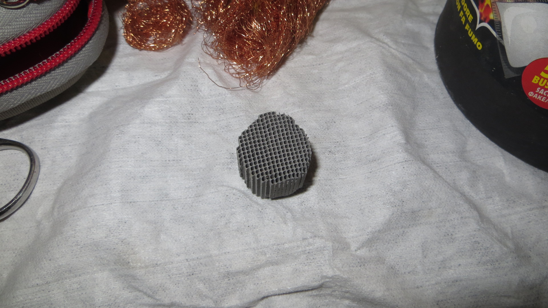

This time I went with platinum (+rhodium) catalyst scavenged from a catalytic converter of a diesel car.
The thermometer with this type of catalyst was not read as much as with copper, but what does it tell you? Is the platinum cata better because the reaction without air is slightly endothermic?

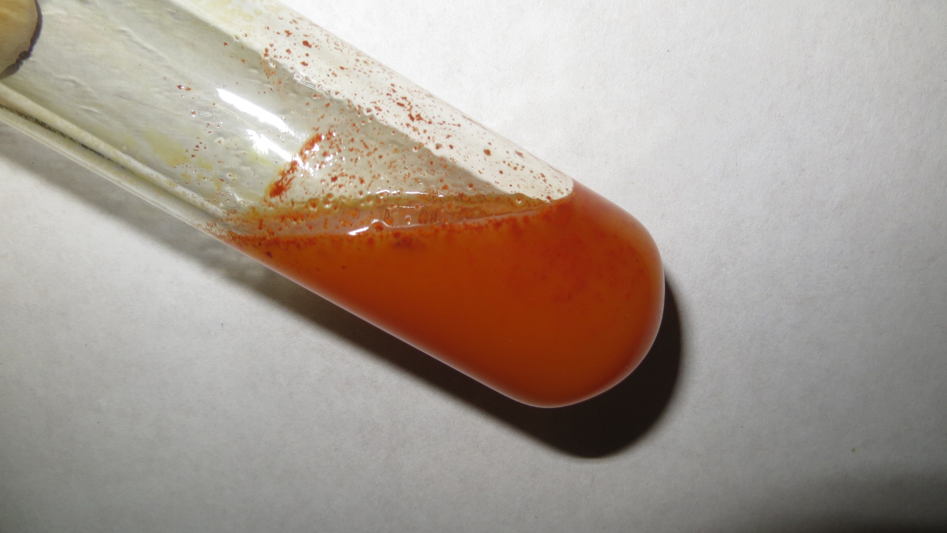

Magpie, any luck with the bisulphite method?
I did a two hours run and collected ~20ml, it started to boil by simply holding the glass in hand. Maybe let the vapor onto dry ice is the only option since the refrigerator was ~-10°C still the acetaldehyde smell was as pungent as without the fridge.
I also did a run with methanol, there was not any formaldehyde present. I realized when I came home that there should not be any, since the CH3-OH requires oxigen surplus to be oxidized and on Pt it tends to go till H2O+CO2.
I hoped to be able to co-oxydize Me-OH with Et-OH to get their aldehydes in the same mixture, but you would need 1-2gMe-OH in 2litres of air to get the oxidation going.
Anyway the Me-OH is a good hydrogenating reagent in this setup (CH3-OH => CO + 2H2) and I think with copper it could reduce many things like NO2 groups to NH2

Magpie, the tiger did not bite! I did a run today with methanol (Cu catalyst), I let air in below and above the filament also, honestly I did not notice the difference, there was a strong smell of HCHO in both cases.
c n atara I read somewhere that alloxan forms in food that is bleached, like flour and some sugars also.. so like it or not we eat it anyways
[*] posted on 27-3-2015 at 15:57
You have developed quite a technology there - well done. I will continue to watch from the door. ;)
