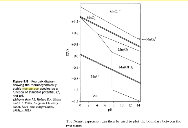

By the atached diagram, it doesn't look as if air would do the job under aqueous conditions.
For alkaline fusions, iron or nickel is acceptable. There will be some contamination, especially if chlorates or perchlorates are added as oxidiser - halogens are bad news even under alkaline conditions.
Mn.png - 13kB
Aqueous standard conditions, to be sure. But the hydrothermal reactions are under conditions decidedly nonstandard. Have a look at this abstract:
Chemische Technik (Leipzig, Germany) 17(8):493-494 (1965)
The effect of reaction parameters on the formation of potassium manganate(VI) from manganese dioxide and potassium hydroxide
Teske, Klaus; Lehmann, Hans Albert
In the system MnO2-KOH-O2, K3MnO4 alone is only formed at a K/Mn ratio of >3 and temps, of >500°. At lower temps. and K/Mn ratios, some K2MnO4 always formed. K3MnO4 was oxidized at 100-300° for 4 hrs. in O and a PH2O of 23 mm. (PH2O = pressure of H2O vapor). From ∼ zero at 100° the conversion to K2MnO4 was practically complete at 150-200°, and almost completely reversed at 300°. In air, the range of max. conversion was narrowed (175-200°), but increased (175-300°) by raising the PH2O to 107 mm. With increasing PH2O at 250° for 4 hrs., the conversion was almost complete at PH2O of 82 mm., and raised only slightly at PH2O of 150 mm. Addn. of an equimolar amt. of KOH lowered the initiation of the thermal decompn. of K2MnO4 from 500 to 200°, and caused almost complete decompn. at 250°. The addn. of more KOH caused only a slight further lowering of the decompn. temp. In the presence of moist O and KOH, K2MnO4 decompd. at 200-75°. The results may be partially explained by the equil.: 2K3MnO4 + H2O + 1/2O2 2K2MnO4 + 2KOH.
That will give you an idea of the conditions needed to effect oxidation to manganate. The phase diagram above is based off standard electrode potentials: 25 deg. C, 1 atm, 1M solutions. None of these is the case with a reaction at high temperature, increased pressure, and highly concentrated solutions used. Nor is the paper above the only reference to air-oxidation of MnO2 to manganate at high temperatures. A Japanese patent (JP 55085425) describes production of K2MnO4 at 275 deg. C and 3 atm with air the only oxidant.
Bear in mind also that preparing BaMnO4 instead of K2MnO4 means that, even if the equilibrium concentration of manganate is very small, the formation of barium manganate need not be hindered because the substance is highly insoluble.

... Though as far as oxidation of HCl by KMnO4 goes, this is said by at least several references in Brethericks to have given a sharp explosion when conc. HCl was added to solid KMnO4, the explanation was that there is a remote possibility of the permanganate oxidizing the Cl2 to "chlorine oxide". ...
Finally understand now. For the preparation of Cl2 using KMnO4 and HCl, the KMnO4 should have so much water over it, just so that it's covered. Because action of hydrochloric acid onto the dry crystals easily forms small amounts of gaseous MnO3Cl, which can't be entierly removed by washing with water. In light, the permanganyl chloride also decomposes into Cl2O and MnO2. This all being found out by Kümmel, Wobig (Z. Elektrochem. 15 [1909] 252).
