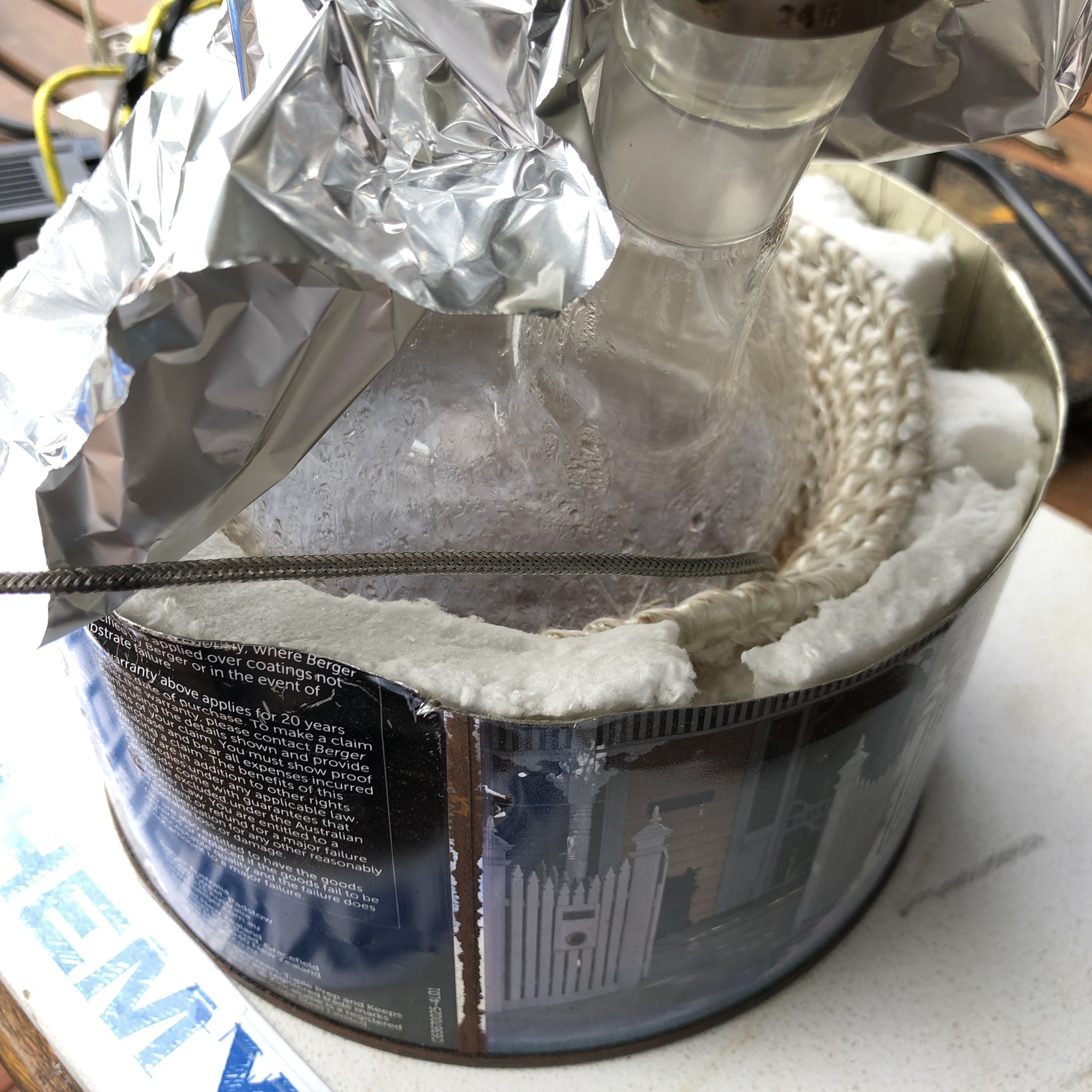

Testing out my heating mantle today. Last year I bought a replacement mantle for a 500 ml heater off eBay for 10$ I placed this into an old paint can for the base and packed the surrounding space with Kaowool. It was powered with a PID/SSR combo which was also from EBay for under 25$ last year. The leads are some old sections of oven wiring harness. I understand the 400c PID devices are cheaper still which would suit this application just fine. I’m using it to distill Glacial Acetic Acid and it works very well. So that’s a home made heating mantle for under 50$. I did run it at max power for a short while and it can get to about 330c. I wouldn’t run it like that most of the time due to the possibility of the nichrome burning out but these mantles are cheap enough so that’s no problem if it did. I bought 3 of them.
934BC68E-7FD1-4899-ABB3-0C3B02807246.jpeg - 1.8MB

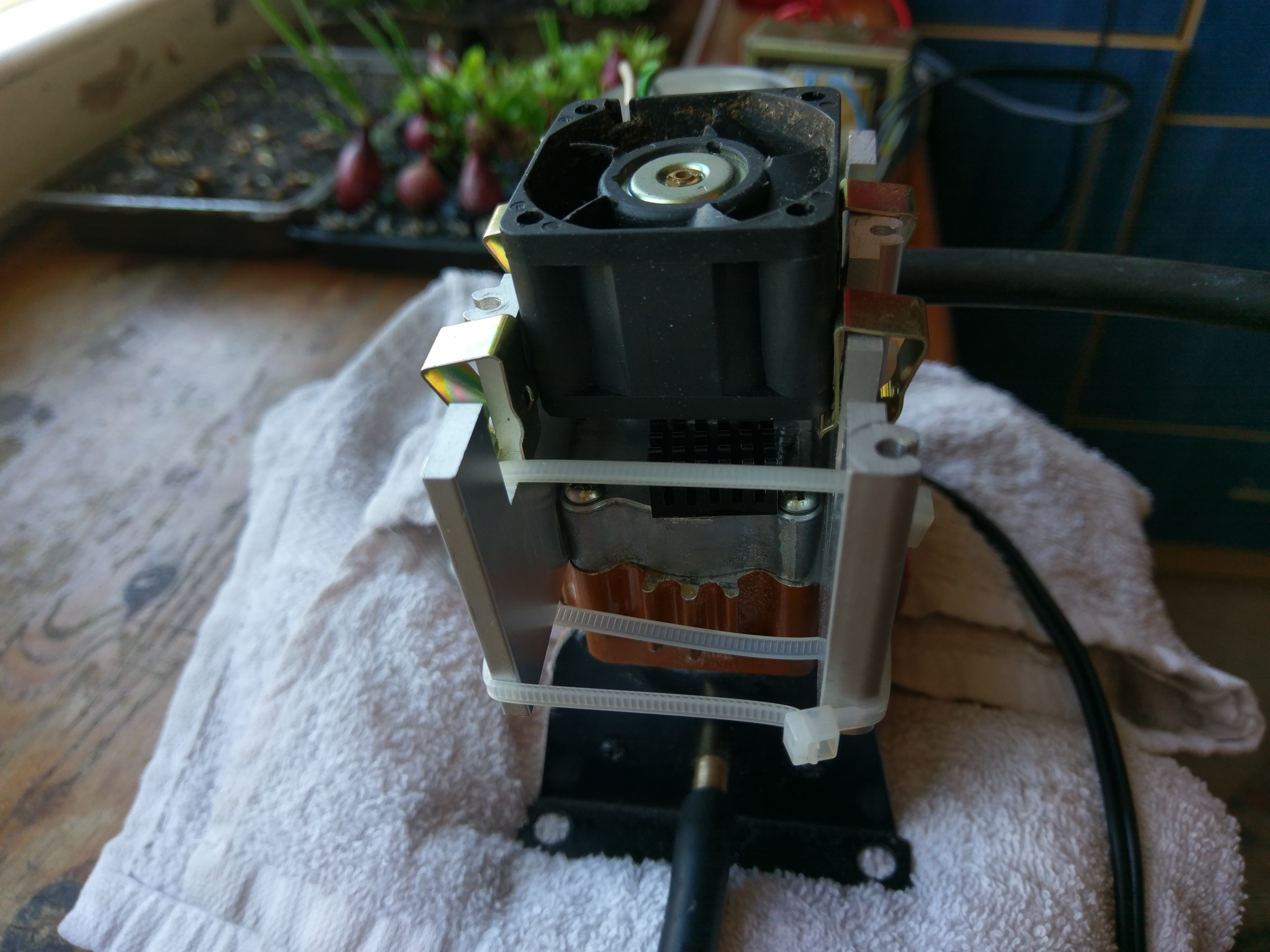

Vacuum pump and vacuum filter
Here Is my gem, vacuum pump made from 12V compressor.
It has a nice high power motor
IMAG1753.jpg - 2.5MB
It takes air from every hole in the motor and parts, so they are sealed with super glue.
IMAG1748.jpg - 2.3MB
Made a hole in the part where piston is and added a nozzle for hose.
IMAG1749.jpg - 2.4MB
TheMrbunGee
Posts: 364
Registered: 13-7-2016
Location: EU
Mood: Phosphorising
[*] posted on 15-4-2018 at 01:33
Active cooling and some heat sinks (it was getting hot quite fast)
IMAG1750.jpg - 2.4MB
Power supply from a transformer and bridge rectifier. it eats 6-7A, and about 12, when maximum vacuum is reached. Rectifier is sandwiched between aluminum to dissipate heat.
IMAG1751.jpg - 3.1MB
And the filter - just a jar with a funel.
IMAG1752.jpg - 2.4MB
I was able to boil water in 54 Celsius. If I am not wrong its about 120 torr?
