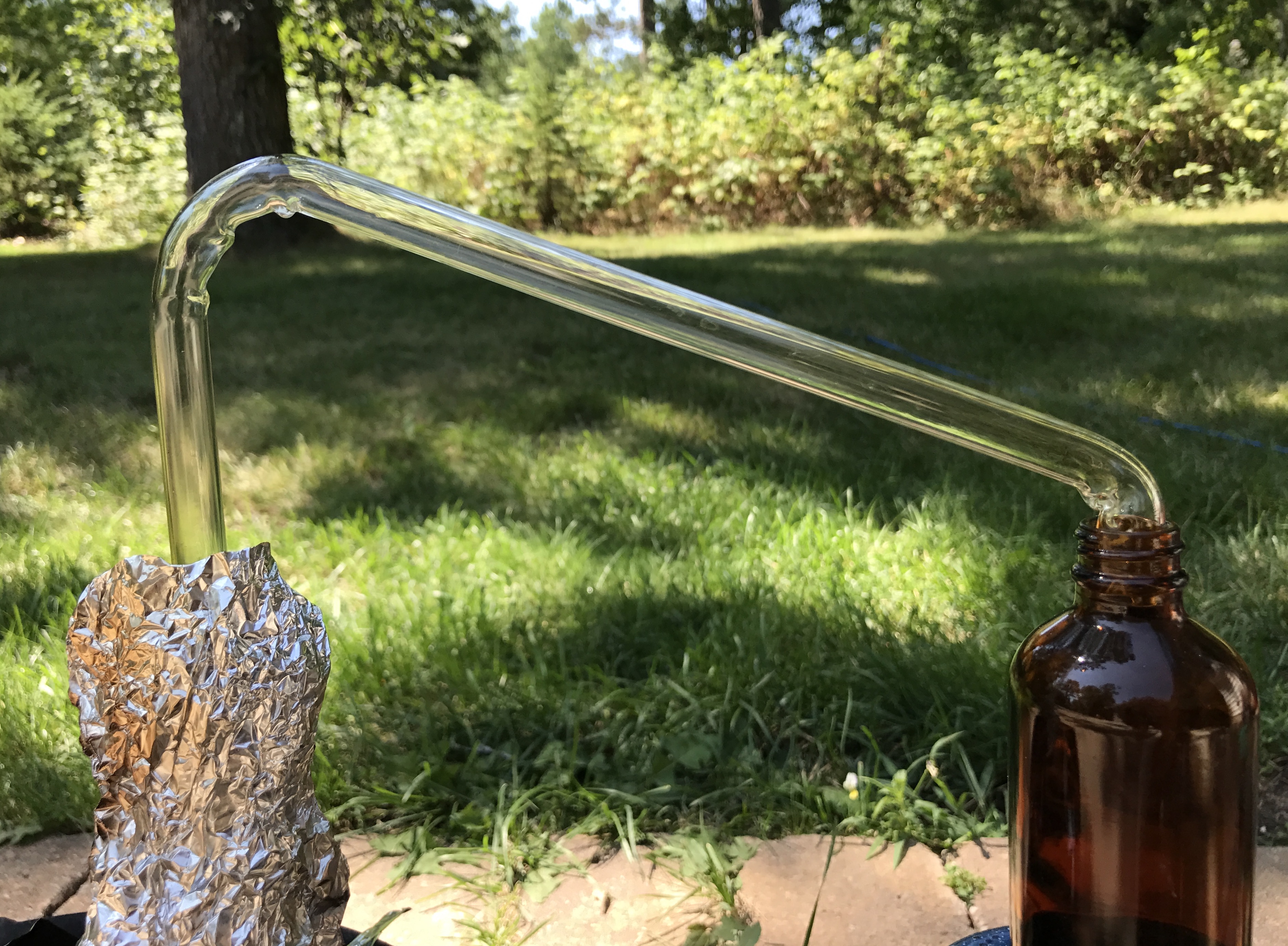

My first attempts as making glass pipettes. The top two are made from glass droppers (right) and the bottom two are made from glass tube. The bottom
ones are blackened because I pressed the hot glass on a piece of wood to flare the edges, got a nice deposit of soot. Would metal cause cracking?
I heated the last 1.5cm of the tube while rotating until the hole closed and the glass softened enough for it to droop when rotation stopped. Then
using a pair of tweezers I grabbed the end and carefully pulled it out. The faster pulled the thinner the tip will be.

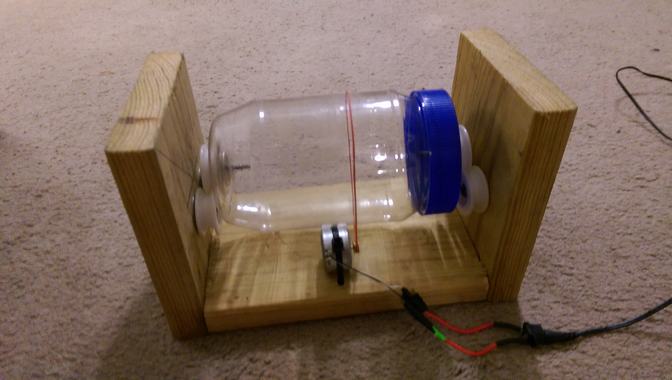

I tried to make a ball mill from a peanut butter jar, the bearings out of a dishwasher, and a severely under powered motor. It lasted for a good 20
seconds.

Quote: Originally posted by Plunkett | I tried to make a ball mill from a peanut butter jar, the bearings out of a dishwasher, and a severely under powered motor. It lasted for a good 20
seconds.
Yeah, ball mills seem so easy. But after fiddling with jars, rubber belts, caster wheels, and a few motors for months, it's still unreliable and cost
way more just buying one from harbor freight.
I eventually caved and just bought the single drum with the 20% coupon for about $30. Then bought a dual drum a year later since they're so useful.
Small ball mills aren't worth the effort, but very large ball mills (much more efficient, much finer grind) are absolutely worth it if you have the
space and time

Quote: Originally posted by Geocachmaster | My first attempts as making glass pipettes. The top two are made from glass droppers (right) and the bottom two are made from glass tube. The bottom
They’re nice, I do a bit of glass work myself, usually making odd bits out of tubes. I find the best way to get the soot off is to heat it in a
strong oxidising flame - once it starts glowing red then it’ll sublime off and leave perfectly clean glass. Metal won’t cause it to crack if

Homemade Distillation Setup
It's nothing too fancy, but I figured I would share my homemade (janky) distillation setup from awhile back. It's certainly not an aesthetic piece,
but it successfully distilled over 50mL of concentrated nitric acid on its first use. It's surprising what one can do with a wine bottle, glass
tubing, and a propane torch.
