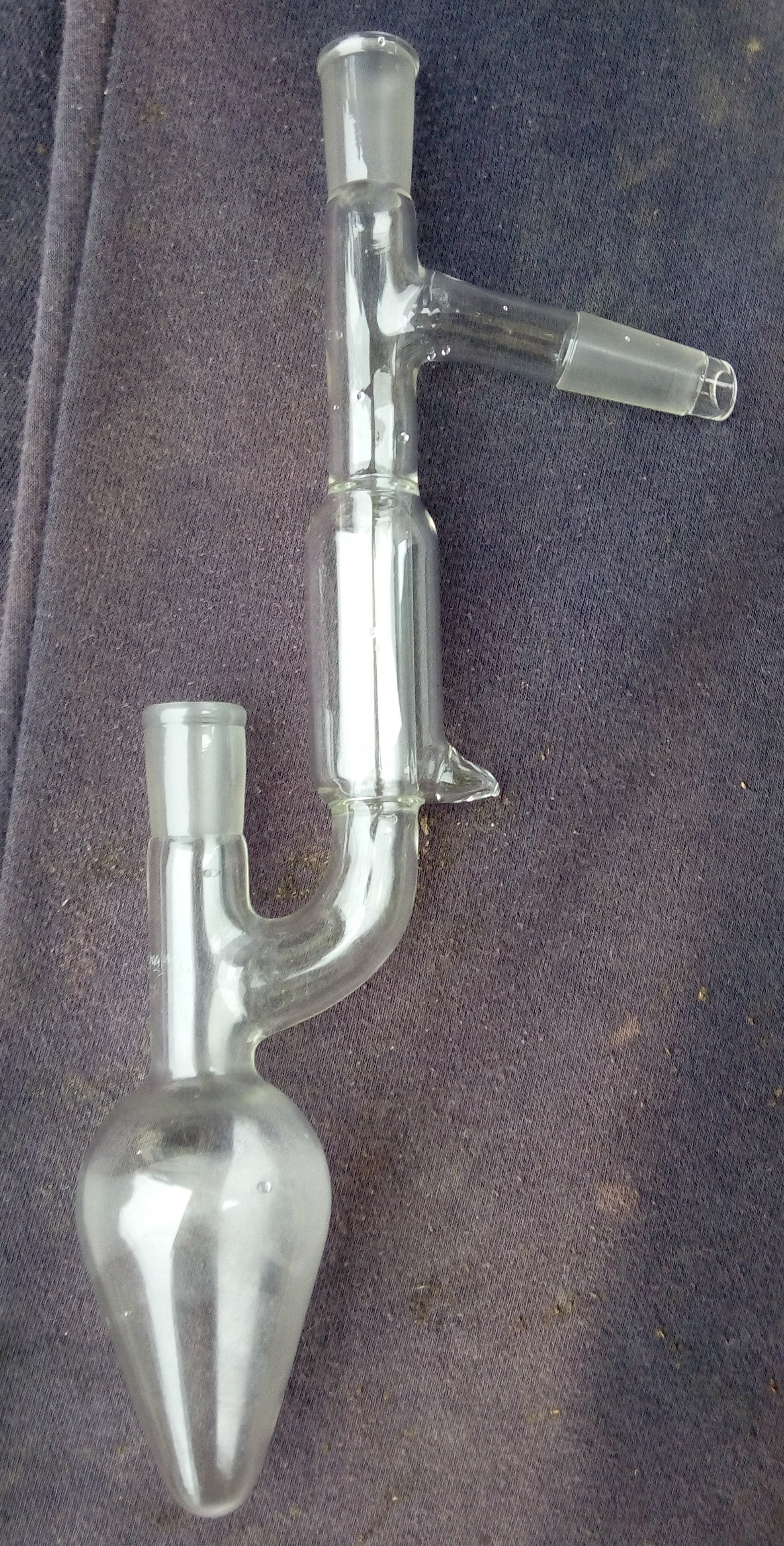

[*] posted on 23-9-2018 at 01:16
Is this for low or high temperature b.p. ?
As part of a job lot of used glassware I have had this piece, unused by me, for a few years.
B14thing.jpg - 3.1MB
The joints are 14/23, the flask is 25ml, and I assume that the jacket is vacuum.
Would this have been made for use at lower temperatures (ether, ethanol etc.)
or for use at higher temperatures (kerosene, mercury, sulphuric acid etc.) ?
How would the vacuum jacket help anything ?
(no obvious way to put packing in that section)

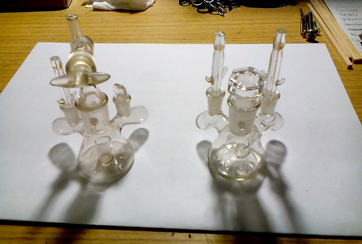

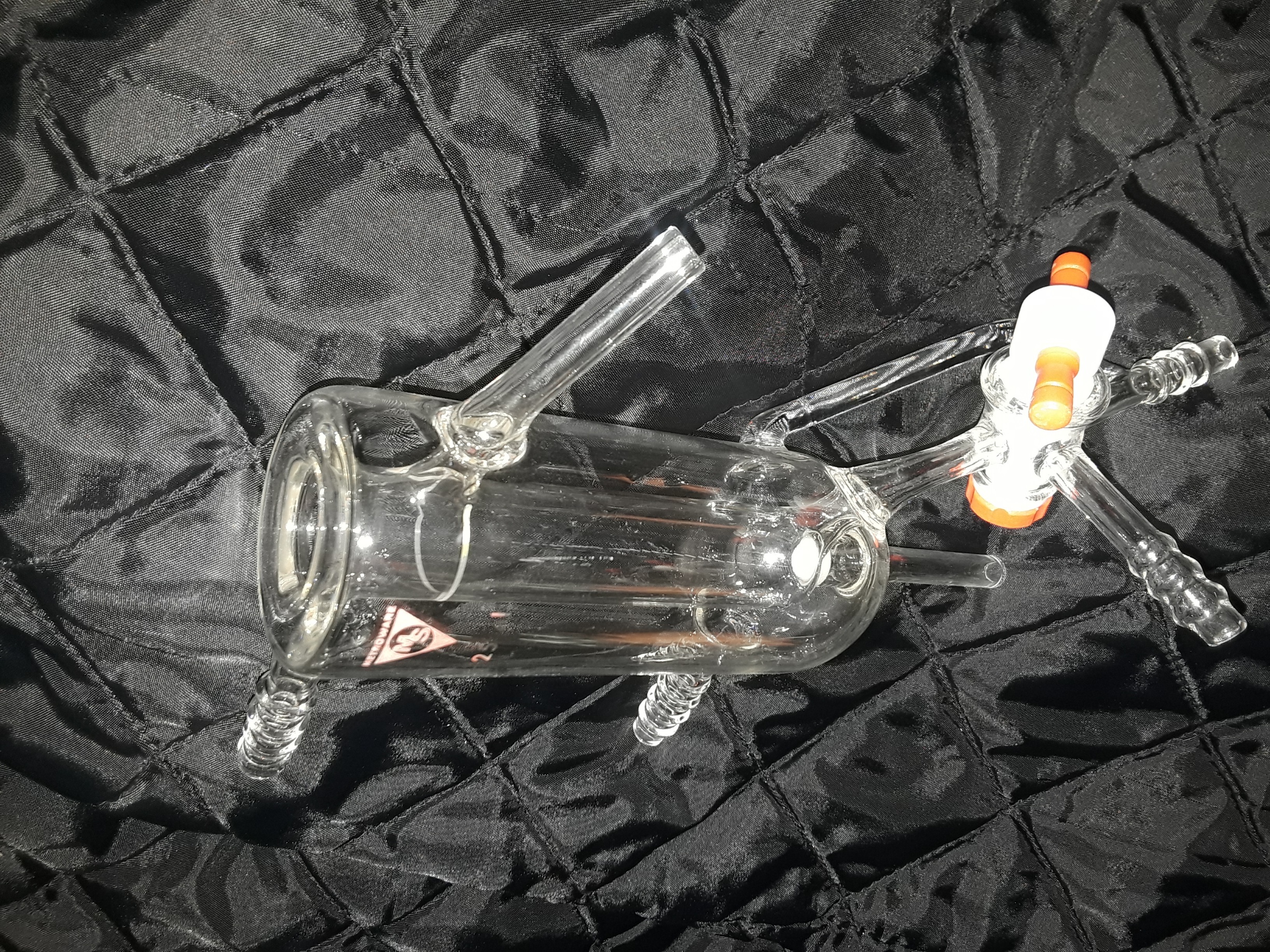

Weird glassware identification
Hey guys,
could you please help me to identify this thingy?
44557868_254722738521296_1491345123437445120_n.jpg - 132kB
Posts: 4332
[*] posted on 20-10-2018 at 14:55
We have some similar-looking glassware that I've been meaning to post here, but nobody has any idea what it is, or was used for.

[*] posted on 20-10-2018 at 15:12
From the pictures, it looks like a miniature distillation (possibly Dean Stark) apparatus on a small scale. The small protruding lobes can collect a small amount of refluxing liquid before it overflows I assume, which can be used for both purifying or drying a substance.
The philosophy of one century is the common sense of the next.

[*] posted on 20-10-2018 at 15:33
These are flasks used in a Warburg apparatus for tissue culture. One port of the flask connects to a manometer to measure the evolution/uptake of gas(es). See Wikipedia. I encountered these in the 1960's. No doubt they have been supplanted by some automated gizmo now.

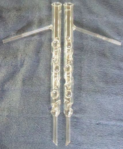

[*] posted on 24-10-2018 at 09:11
All the vigreux columns I see just have the 'fingers', but these two distillation columns I found have 'fingers' and 'melons'. Does this style have its own name?
200_8612.JPG - 49kB200_8616.JPG - 73kB

[*] posted on 24-10-2018 at 16:16
If the pictures were shown to glassblowers I would guess they would call them old. You don't say the brand like that wouldn't help...does their current catalog not have such a thing?
It's a pear-shaped Claisen flask with a nifty yet rare vacuum jacket, which helps to keep it it from becoming a condenser. It can be used in whichever simple distillation but would probably be at its best in high vacuum, with the length as a mist/bump trap. A perfect fit in the cannabis distillate for home use thread.

Sorry, I think theyre corning [they were obtained used both in a cardboard sleeve that said corning] but theyre not in their current catalog, theyre probably at least 30 years old. I just thought someone might recognize the unusual style.

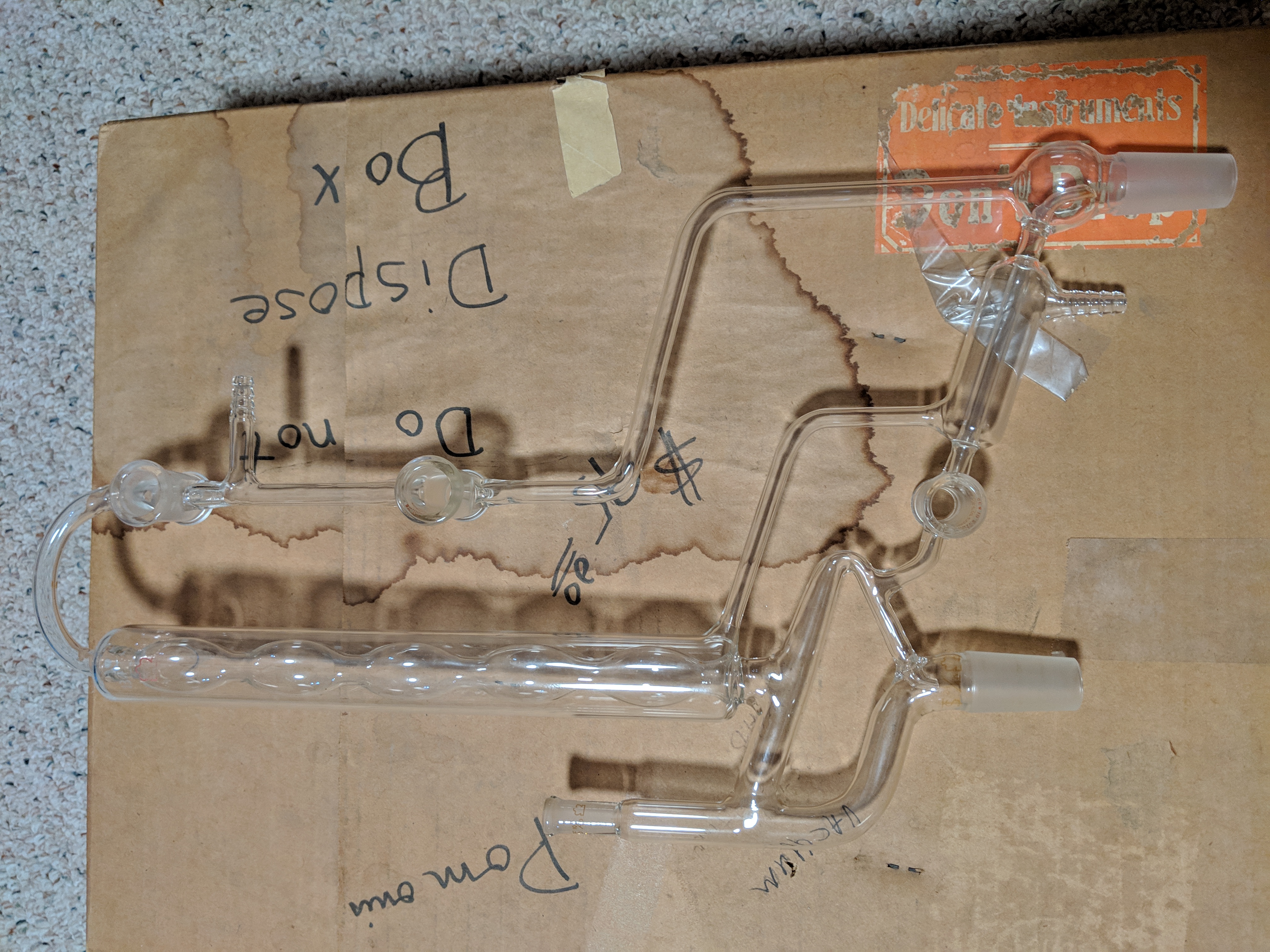

[*] posted on 12-3-2019 at 04:00
Custom (?) Distillation Head
I was gifted this unique piece of glassware yesterday. I was told it is a custom piece that was made in the 1950s or 1960s. Does anyone have a guess as to what it's specific purpose would be?

[*] posted on 12-3-2019 at 04:37
Looks like a Perkin Triangle for cutting fractions during reduced pressure distillations, with a partial take-off option.
... I want one. https://en.wikipedia.org/wiki/Perkin_triangle

[*] posted on 12-3-2019 at 06:51
I'm not overly attached to it just yet, so shoot me a U2U if you're interested in it...
