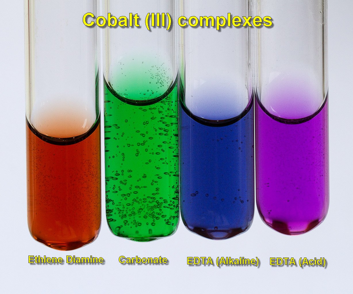

nezza - 25-6-2017 at 22:53
I have made some Cobalt(III) complexes before including the carbonate which is bright green. I have never tried to make the oxalate, but I'll have a go at it now.
Cobalt (III) complexes.jpg - 231kB
Most of them are fairly easy to make from cobalt(II), the complexing reagent and hydrogen peroxide.

Interesting! From your photo I can tell you've been able to get your hands on some really hardly accessible chemicals. Congratulations on that aspect! However I would like to know if you have made any complexes that are more achievable in terms of reactants to the average Joe(any ventures into the chemical complexes of other transition metals would be welcome as well :) ).
I would especially love to know about your work on the carbonate complex seeing your proof of product! Nevertheless, I look forward to hearing your results on the oxalate complex as well! I'm too scared to scale up my experiments because I'm still unaware if it works and I really don't want to waste some expensive cobalt...

nezza - 28-6-2017 at 02:36
The cobalt(III) carbonate complex is easy enough.
Mix cold sodium bicarbonate solution with dilute H2O2.
Add a cobalt(II) solution. There will be a muddy green precipitate and some effervescence.
After a few minutes the green precipitate will go into solution.
The solution will still release oxygen slowly and it is not indefinitely stable.
It is not cobalt(II) carbonate as that is pink or blueish and insoluble in water.
