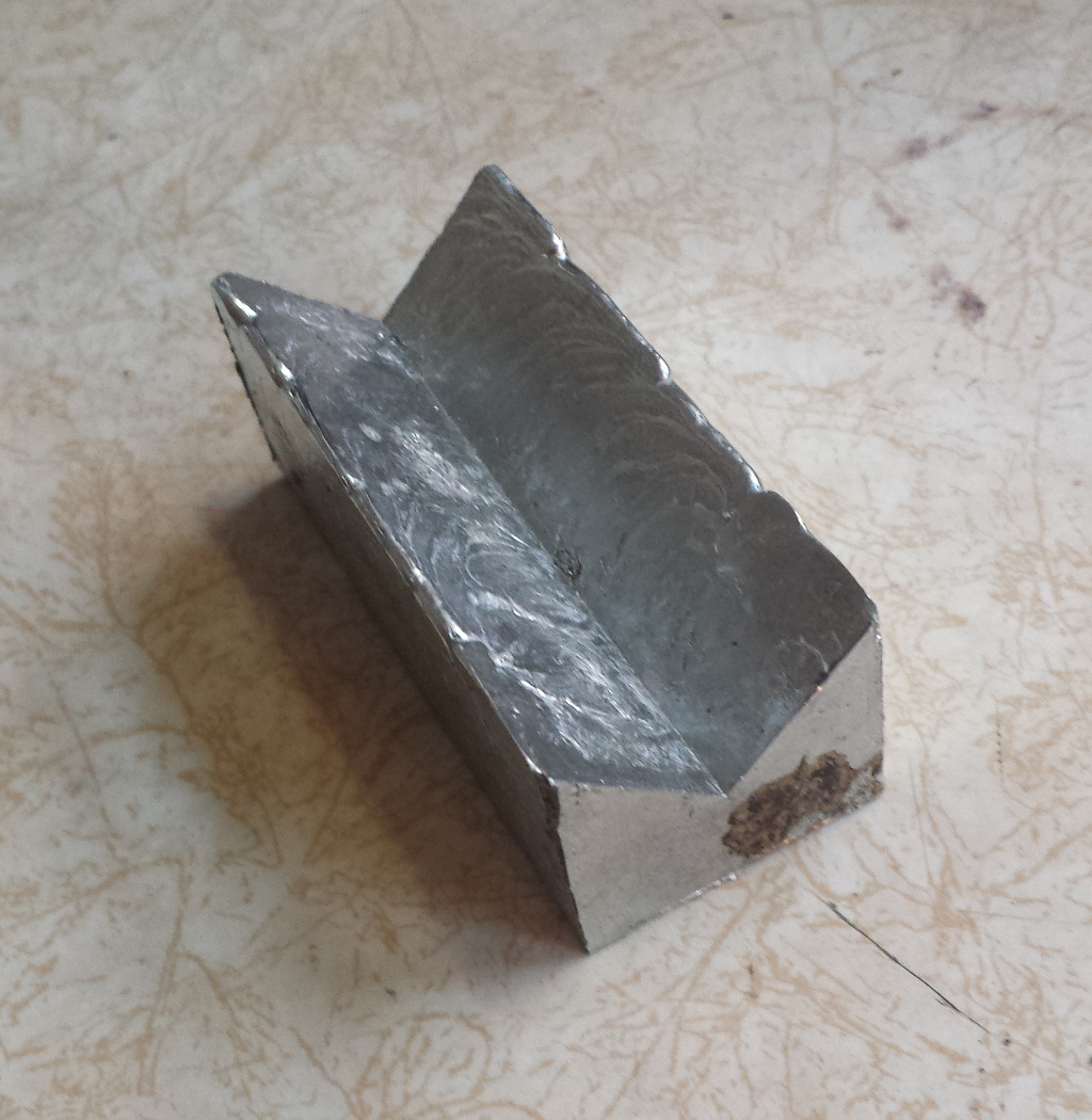

Your analysis of the problem (oxide coating acting as a skin) is exactly right in my experience. About 8 months ago, I cast a V-block out of zinc (see attached photo) which I then drilled and tapped to make a custom mounting bracket. It took me several attempts. I found the ammonium chloride works very well as a flux. I have a few tips/cautions for you:
1) If your zinc is catching fire on contact with air, you are getting it way too hot. I did this too at first because it didn't seem to be melting, so I heated it further. I nearly had a disaster when the super hot molten zinc worked its way through the wall of the container I was heating it in and blobs of flaming metal began pouring out, turning to white zinc oxide as they fell, making pretty blue-white flames.
2) Molten zinc doesn't have a very high vapor pressure at close to its melting point but I would still recommend ventilation. If you heat it considerably above the melting point then you may get metal fume fever from inhaling zinc vapor and zinc oxide dust. This is not usually serious but from what I've heard it is nasty for a day or two (flu-like symptoms)
3) Use extra zinc beyond what you need. Mix in a liberal amount of ammonium chloride. You will end up with quite a bit of dross on the surface of the melt which you will need to spoon-off before pouring.
4) Beware that ammonium chloride will decompose into ammonia (NH3) and hydrochloric acid vapor when heated. This will require very good ventilation like being outdoors or in a fume hood.
Sean
raw bracket.jpg - 482kB

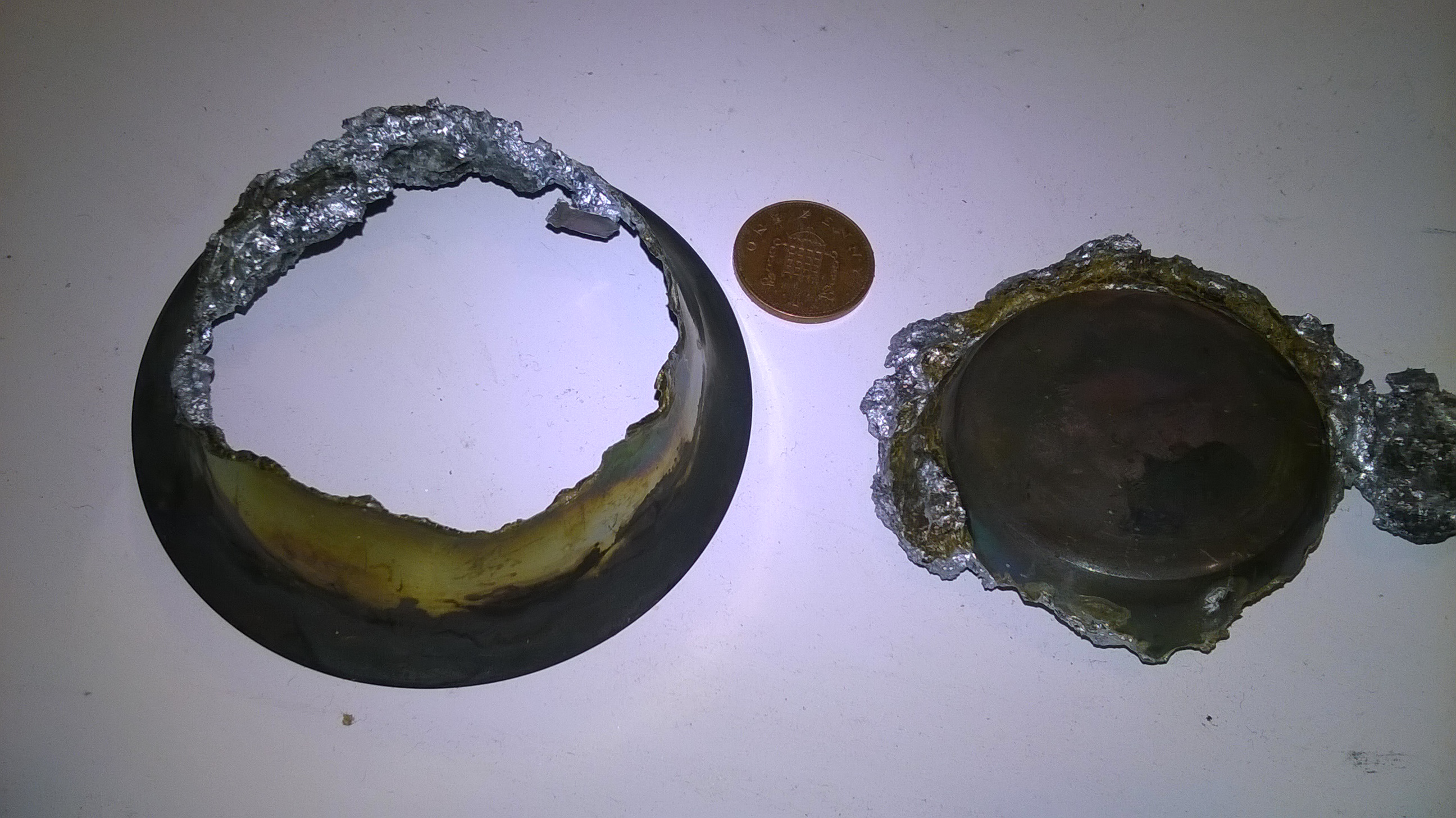

I suggest caution when using it with a powder incase it has thermite properties. Also the molten zinc will wet stainless steel in the presence of a flux and can rapidly dissolve/degrade it. Possibly steel crucibles too. See the effect it had on my nonmagnetic stainless steel crucible in the pic below.
WP_20160425_00_29_57_Pro.jpg - 1.1MB
