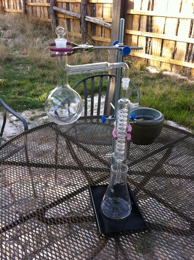

I bought a distillation apparatus last week. I got it in on Friday, and I've only used it once. It's not Pyrex, but seems perfectly acceptable, especially for a beginner level one.
Also, it's a great deal and comes with all of the hardware required to support it, including an extremely heavy duty ring stand that I am very impressed with. You can buy the exact same kit here:
http://www.cynmar.com/ProductDetail/11K21640_Distillation-Ap...
Also, the picture on there is kind of bad, so here's a better one that I took:
IMG_1159.jpg - 461kB

That hole is for cold water to go in, so that the condenser can condense the vapours.
Texium - 24-3-2014 at 16:47
No, that hole is the output for the cooling water. I just didn't have anything attached there in that picture.
The condenser that it uses is a Graham condenser, so the distillate runs through the coil, and the cooling water flows around it. The distillate drips out of the bottom, into the flask.
So far the only thing that I've distilled with it is store bought ammonia, to remove the surfactants. I plan on doing much more with it in the upcoming weekends though!
The cooling water always goes in the bottom and out the top, so that the condenser is full of cold water.
Oh… oops, yeah, that makes sense… I was doing some weird thing in which I was letting off water from the bottom occasionally and letting more flow in from the top, now I realize how counter-productive that is.
Thanks!
Also, since I work outside on my patio and don't have access to a faucet other than the garden hose which is usually rather warm, I have a plan to attach a large funnel (improvised from a milk jug) to the arbor and pour ice water in there, letting it gravity feed into the condenser.
[Edited on 3-25-2014 by zts16]

Texium - 24-3-2014 at 17:18
Yeah, a faucet works great if you have close access to it and the water is nice and cold. If the tubing won't connect, you might be able to buy an adapter that will fit. In the classrooms at my school, the sinks have little threaded pointy adapters so you can work a piece of tubing onto them. Otherwise, gravity feeding is the only thing that I can think of. Or if you're really desperate, spraying it in with a wash bottle! (:
