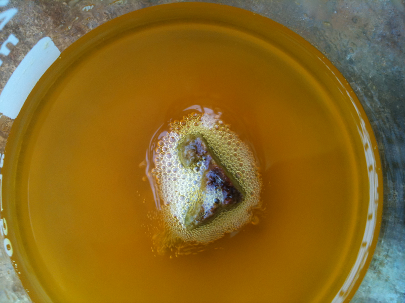

Here are couple of pics disolving, solution goes more orange after some time.

Before you've at least half digested it, the ore's composition will not reveal itself. So you'll need to grind some of it extremely finely and subject it to various extreme conditions like conc. H2SO4, fusion with bisulphate, conc. HCl, fusion with alkali or boiling with 50 % KOH. Then some chemical tests may reveal something about its chemistry. To be honesr, its no mean task for anyone: ore analysis....
The fizzing clearly points to a carbonate matrix (CO2 being released by acid action: the red may be iron oxide - suspended in it and which will NOT necessarily dissolve in your conditions). Try filtering to clear and evaporating the filtrate: what do you get?

Yes this looks like a carbonate and the colour is definitely due to a dispersion of fine iron oxide material; you didn't mention the effervescenes before. As a carbonate that dissolve easily it is likely to cantain calcium hence the precipitate of gypsum when you add sulphuric acid.
