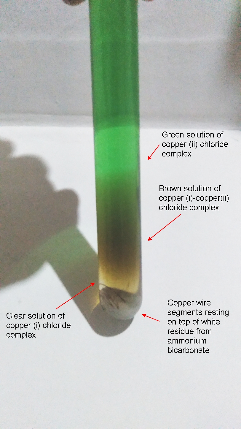

    bnull - 26-11-2024 at 05:59
    Quote: Originally posted by averageaussie
    apparently concentrated HCl with oxidisers present can attack copper... seems like anecdotal evidence at best, likely someone added a nitrate salt to HCl.
    10% HCl does it pretty well. I never had any issues with the watery stuff from the hardware store. As for the anecdotal part, put NaCl brine or HCl in a test tube and add solid copper sulfate. When it has dissolved, drop some copper wire or scraps and leave the test tube alone for one hour. Then examine the copper and the solution, which will be deep brown.
    Adding a nitrate would a very bad idea: NO2 is given off, whether you can smell it or not, and it gets worse with heating. First hand experience.
    The crux of the biscuit here is the combination of the oxidising properties of copper(ii) chloride with the formation of chloride complexes ([CuCln](n+1)- perhaps, I forgot how much is n). It goes like this:$$Cu(s)+CuCl_2(aq) \rightarrow 2CuCl(aq)$$ for the dissolution of metallic copper, and $$4CuCl(aq)+4HCl(aq)+O_2(g) \rightarrow 4CuCl_2(aq)+2H_2O(l)$$ for the regeneration with air. You can even use an alkaline chloride (table salt, for example) in the first reaction (there must be an excess of chloride ions, no matter who supplies them) and reserve the hydrochloric acid to dissolve the newly formed copper hydroxide after the regeneration.
    Ullman's Encyclopedia of Industrial Chemistry, chapter on copper compounds, section on copper(i) chloride:
    The copper(I) chloride solution is produced, for example, by mixing a copper(II) chloride solution with metallic copper in the presence of hydrochloric acid or sodium chloride. The colorless to brown solution is stable only in the absence of air
    because air oxidises Cu(i) to Cu(ii).
    An example of process:
    1. Make a copper(ii) chloride or sulfate solution with extra chloride ions. If you have a way to contain the vapors of hydrochloric acid, use it. If not, sodium or potassium chloride will do, and you can save hydrochloric acid for the regeneration;
    2. Add copper. Since the insulation in the old ones is cracked, beat them a few times with a stick to remove most of the flakes. The ones that can be stripped should be stripped.
    3. Leave the solution alone for some time. Check in each day to see what color it is. If deep brown, it's time for regeneration.
    4. Regenerate the etchant. If you used hydrochloric acid in the beginning, simply stick a hose from the aquarium air pump to the bottom of the solution. It goes from deep brown to bright green, when it's time to leave it alone again to dissolve more copper. If you used an alkaline chloride, stick the air hose the same way as before, and when it becomes bright green turn off the pump and add hydrochloric acid to dissolve the hydroxide and oxychloride and whatever else that precipitated.
    You can leave it unattended for however long you want because there is no risk of foaming or hydrogen gas or production of a corrosive spray. No electricity is used except during regeneration, which is so simple that you can do it while reading a book, as long as you can see the color change.

    I cut about 50 cm of varnished copper wire from an old de-Gaussing coil. After burning off the insulation on a spirit lamp and removing the charred residue with a wood sandpaper, I made it into a multi-turn loop and inserted it into the test tube in a way that most of it remained submerged. The loop slipped to the bottom of the tube. I used used some expletives (bugger that, I won't fish it) and left the tube alone for about eight hours.
    Later that night (0h32m):
    20241208_003201.jpg - 714kB
    Notice the three liquid phases. Green is relatively rich in oxygen, so most if not all of the copper is copper (ii). Brown has a considerable quantity of copper (i) and is very poor in oxygen. A clear, transparent solution means that all the copper present is copper (i), with no oxygen whatsoever in solution. The white stuff is apparently silicon dioxide. Most of the copper wire was gone. The distribution of the phases was affected by the diffusion rate of oxygen through the solution. The relative size of the phases is about 8 green to 3 brown to 1 clear.
    I attached another length of shiny copper wire to a small motor and used it as a stirrer to mix the three phases and dissolve more copper. The solution became yellowish, as an unfiltered wheat beer (straw yellow). I added 10 drops of 15% HCl to a small section of the top phase without disturbing the rest of the solution. It immediately turned brown. Today, two days later, the solution is a dark amber color with a greenish precipitate of oxychloride or hydroxide or basic carbonate, or a mixture of the three.
    The presence of ammonium cations indeed increases the rate at which copper dissolves. The patent may be right about a 50-fold increase after all .
    On hindsight, I could have made ammonium chloride from table salt and ammonium bicarbonate and used the solution, which would need less HCl.
