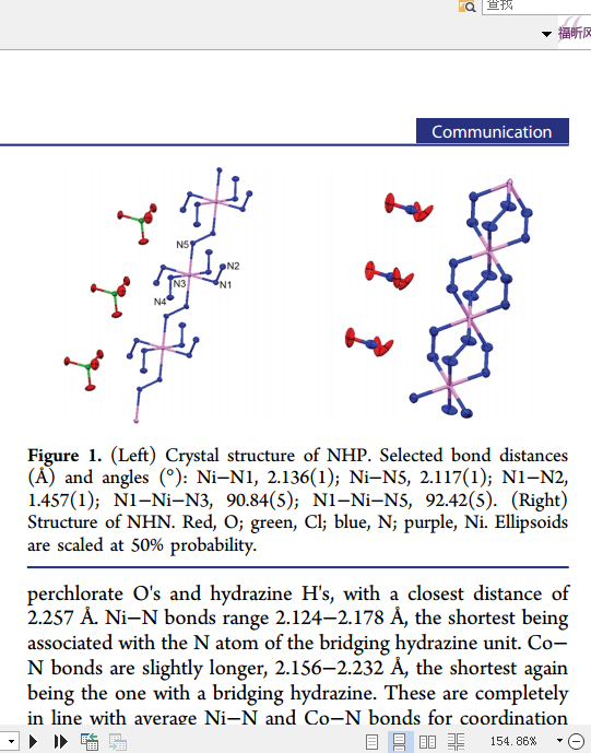

Actually,the molecular formula of Nickel hydrazine perchlorate is [Ni (N2H4) 5] (ClO4) 2, In a paper published in JACS.The title is "Ionic Polymers as a New Structural Motif for High-Energy-Density Materials",Received: October 13, 2011,Published: December 17, 2011。
The thesis describes the NHP molecules and the crystal structure obtained by X-ray diffraction.
[Edited on 26-4-2014 by detonator]

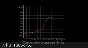

Laboratory of Liptakov - 2-2-2015 at 02:12
The my patent process is on a good way. Therefore, I can give important insights into the double salt TeACP. Measured by dent plate. Pure TeACP also loses ammonia from the molecule. In the dry powder state very soon, during 3 days. In the pressed state at 1.8 g / cm3 as well. After 20 days (at 20C) begin to fall explosive properties. This can be prevented, in other words, importance to limit the loss of NHx.
With plasticizer PIB 2% + 2% oil 5W40. This is key. This mixture is safe for compression. This mixture has a zero oxygen balance. Detonation velocity is very high. (graph) It is possible constructions SC or EFP devices. It is here in threads. Everything device (LL produce) is just filled with this mixture. TeACP grain fraction is 0.05 -0.2 mm. Wet 5% H2O/NH3. Then mixed with a plasticizer, dry heptane, and pressed of 1.75 to 1.85 g / cm3. Production TeACP is very easy, video here: https://www.youtube.com/watch?v=MDPa0Od3jws
Proven stability of 4.5 g pellet is 30 days / 20C. The power/VoD/ is the same as tetryl pellet. Detonation pressure at 1,7 - 1.8 g / cm3 is 20 - 25 GPa. (RDX 28 GPa). Initiation No.8.
For more details, I will discuss later. According questions.
...LL...:cool:

PHILOU Zrealone - 3-2-2015 at 12:45
...LL...:cool:
Is it normal that the VOD drops down between 1.8 and 1.9 g/ccm?
Dead pressing effect?
I will just point out that if TeACP is already very good, then by watching at the document proposed by Franklyn into Energetic Materials in "tetraamine copper nitrate sensitivity" tread (posted on 30-1-2015 at 07:43)
==> The Combustion of the Salts of Tetramine Copper II
www.dtic.mil/cgi-bin/GetTRDoc?AD=AD0779649
In this document they expose the speed of combustion of various copper tetramine salts to be in the order BrO3(-) > ClO3(-) > ClO4(-).
So TeACBr > TeACC > TeACP but TeACP is much stabler.

Brxx
Laboratory of Liptakov - 3-2-2015 at 13:07
Highest density (TeACP) was 1.91 g / cc. Technically. All shows on the effect of repressing. It is possible that a group of Br04, BrO3 and Br (IO3) is better than ClO4. But research in this direction was not. I know the document two years. xx AD0779649.
...:cool:...LL
