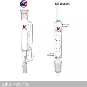

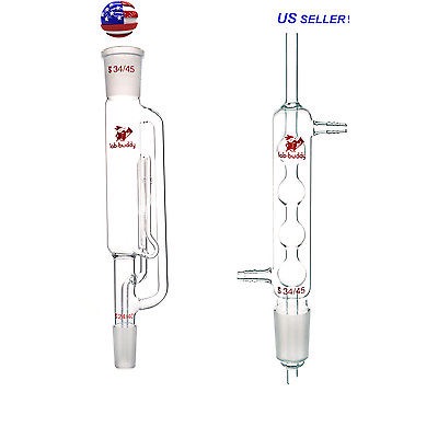

j_sum1 - 20-1-2017 at 21:38
This has probably been asked and answered before, but here goes.
Why is an allihn condenser the standard for soxhlet extractors? It seems to me that any condenser would do the job. But allihns seem almost universal with grahams a distant second.
Sulaiman - 21-1-2017 at 01:39
because most soxhlet kits are sold to essential essences extractors who like the alchemy/apothecary look ?
PHILOU Zrealone - 21-1-2017 at 03:17
I think for practical reasons...
Cooling size efficiency (volume/height) vs double tubular or simple tubular...the only limit is the sky ...but in a lab it is the ceiling ;) ... and the practical working height of the operator :P.
Also robustness vs tubo helicoidal.
[Edited on 21-1-2017 by PHILOU Zrealone]
j_sum1 - 21-1-2017 at 04:32
By that reasoning a Friedrich's would be the most common.

PHILOU Zrealone - 21-1-2017 at 09:06
Yes for efficiency,
but
No because more fragile and expensiver (a lot of precision glassery work).

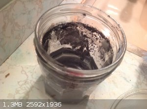

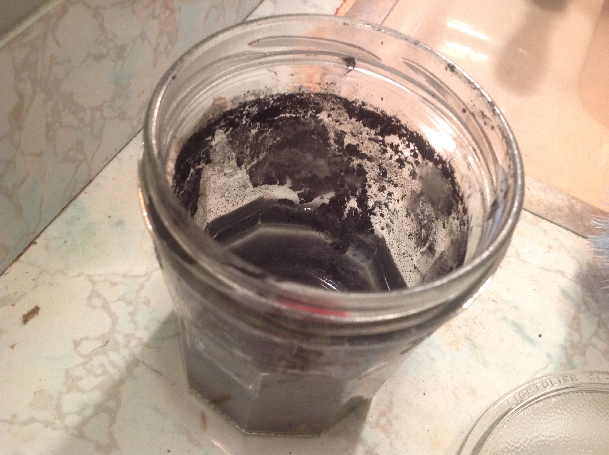

Geocachmaster - 28-1-2017 at 19:59
I recently noticed some mold growth in a container of MnO2 waste, very odd. This was only after sitting undisturbed for a couple weeks though. Do you have a history of/ongoing mold problems in your lab space?
IMG_0434.JPG - 1.3MB
Edit: this is the only time I have ever seen mold in my lab
[Edited on 1/29/2017 by Geocachmaster]
Lithium - 28-1-2017 at 20:15
Geocachmaster, I've never had any kind of mould issues in or on the building itself, but persistently solutions of various chemicals will go mouldy.
Evaporating a solution by leaving it sit on a windowsill is almost nonviable as mould or bacteria will develop before the solution is fully evaporated, requiring filtration, pasteurisation and recrystallisation to purify again.

Quote: Originally posted by TheNerdyFarmer
I made some aluminum Chloride by dissolving aluminum in HCl. Well there was a blackish brownish suspension left so I preformed a Vacuum Filtration to remove all of this. When I tried to clean out the sintered vacuum funnel it was super resistant. Couldn't even get pirranah solution to clean it out. What is this stuff and how do I clean it out?
Where did the aluminum come from? The black-brown stuff is probably silicon. Cast and rolled aluminum alloys tend to contain significant amounts of silicon from the casting process. If this is the case, I don't think that anything beside HF would dissolve it. Remember to use filter paper if you try again.
TheNerdyFarmer - 1-2-2017 at 09:51
I have an idea. If I pass chlorine gas through the funnel, shouldn't the chlorine react with the silicon to form silicon tetrachloride? please leave some input on this if you can. BTW I know that silicon tetrachloride is super dangerous but I don't have HF which is probably more dangerous.
Crowfjord - 1-2-2017 at 18:37
Chlorine might work, but I am not sure. That's a little out of my realm of expertise. By the way, hydrofluoric acid would probably be a bad choice to clean a frit anyway, since the frit would also be dissolved to some extent.
gdflp - 1-2-2017 at 20:21
I'm not sure if that would work near room temperature, I've never seen such a reaction reported. On a more positive note, if you can't find anything to dissolve the silicon and remove it, it's likely that the only consequence to the frit will be cosmetic.
TheNerdyFarmer - 2-2-2017 at 18:13
So if I leave it like it is, it won't bother anything?

Capacity of soxhlet
Geocachmaster - 7-2-2017 at 12:20
I was thinking of buying this Soxhlet extractor, but I was wondering about the capacity. It says 250ml, so I would think that the volume in the extractor is 250cc. However, based on the picture I would say it looks like the extractor could hold 125ml.
Does the 250ml refer to the volume of the chamber or the amount of solvent to be used with it? Perhaps the picture is of a 125ml one or my estimates are off by a factor of two.
IMG_0477.JPG - 23kB
Edit: That was a stupid question, it says right in the listing that I has a 75ml capacity, I should really pay more attention. In that case the "250ml" likely refers to the size flask meant to be used with it.
If anyone else was confused like me the soxhlet size is not actually its volume, the actual capacity of the soxhlet is much less.
[Edited on 2/8/2017 by Geocachmaster]
