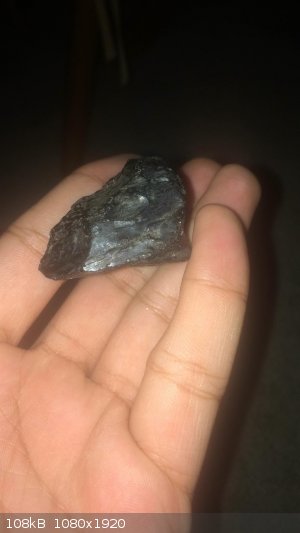

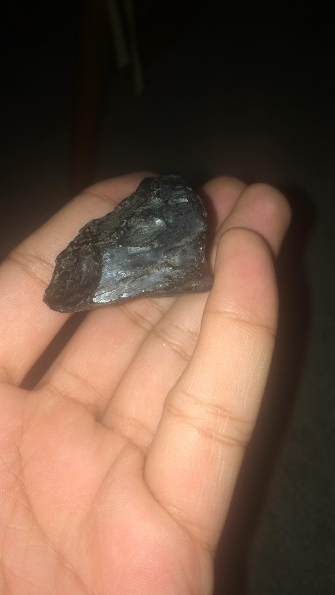

Okay, I went out searching for any radioactive rock specimens near my home( I found one), and I found this other guy here(who seems not to be radioactive):
e37M2t0.jpg - 108kB
So I want to know if this is coal(specifically anthracite coal), any guesses?
It's light, has a metallic luster with a few brownish spots here and there. I actually find quite a bit of this stuff scattered around my neighborhood. All on the surface/stick out to the surface.
EDIT: With some effort, it even writes like a very fine, very light pencil.
[Edited on 1/29/2016 by Velzee]
elementcollector1 - 28-1-2016 at 18:39
Weight/density, if you can? That'd be a pretty good indicator. Is the streak light gray or dark gray?
In my experience, anthracite is a pretty brittle material, and powders all too easily.
If not, could it be graphite?
ganger631 - 29-1-2016 at 00:01

Velzee - 29-1-2016 at 05:27
I found the density to be around 1.24g/cc. I don't have anything suitable as a streak plate, so I can't tell you that.
blogfast25 - 29-1-2016 at 06:00
Chip off a small chunk and see if you can get it to burn? Use a Bunsen or alcohol burner to heat it up sufficiently.
Carbon also reacts with concentrated nitric acid and concentrated NaOH.
[Edited on 29-1-2016 by blogfast25]
Velzee - 29-1-2016 at 10:33
Chipping off a piece was really easy. Placing the piece in the flame of a stove top burner caused the edges to glow orange, and after a minute of heating, the glowing edge turned a white ashy color. The piece fell into stove top, but it never took a flame.

elementcollector1 - 31-1-2016 at 09:45
Sounds exactly like the anthracite I worked with - that stuff needs air influx and strong ignition (kerosene, etc.) to even light.

JJay - 31-1-2016 at 13:01
That looks like shale, but it's hard to be really sure from the image.
